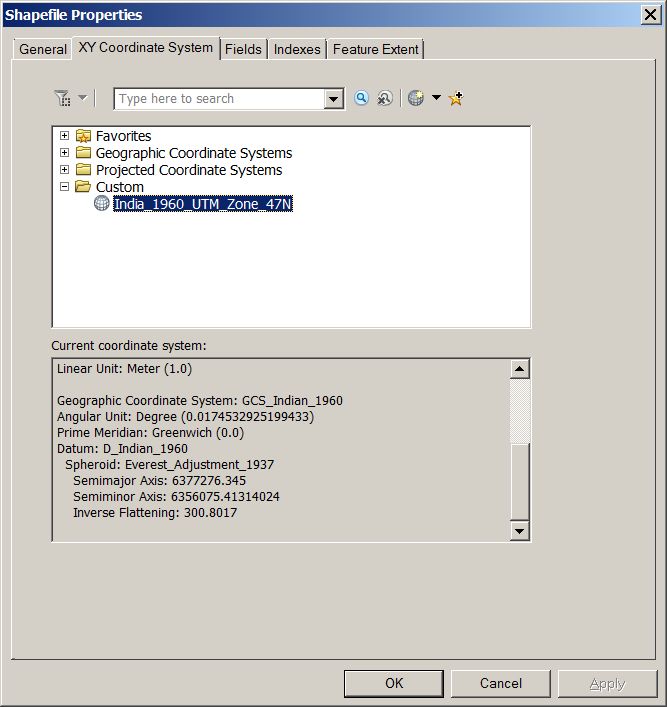

Hello all,
I have been looking for answers, from coordinate systems issues to projection issues but have not found a solution to this sticky one yet. As you can see below, my river SHP does not match the river on the satellite imagery... only by... 400 meters. Coordinate systems and projections are the same (I projected the river shapefile (was WGS84UTMzone47N) to the projection of the imagery. Would anyone have a clue what the problem is?
Thanks!

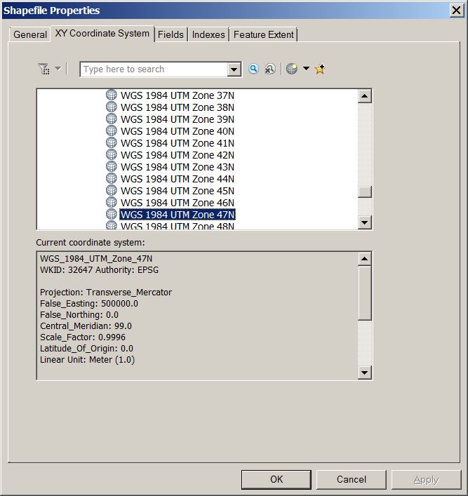

Copy and paster the original. Rename it.
Open up the properties page in Catalog.
Go to the Coord sys tab.
Right click on the coordinate system. 3 option is to copy and modify.
Give the your new coord sys a new name.
Change the GCS at the bottom.
Easy.
FrancoisGuegan
Deactivated User
Thanks so much again - this is now working
