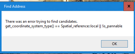

When trying to search for an address using the "Find" tool and the "World Geocode Service (ArcGIS Online)" Locator we are getting a "There was and error trying to find candidates" error message.
We are running ArcGIS Desktop 10.2.2 and Windows 10 Enterprise
See attached image for error.

Rob,
We are aware of this issue and it seems the error is only returned when using the ArcGIS World Geocoding Service or a locator view based on the ArcGIS World Geocoding Service. Here is the number if you would like to track it, BUG-000118837.

I am not sure if this is helpful or not but here is a link to the bug:
BUG-000118837: In the ArcMap Layout view, the error message, "get_c..

This is an error message I am getting in ArcMap 10.7 using World Geocode Service:
Is this bug scheduled to be fixed in a patch to ArcMap 10.7 as well as older versions?
