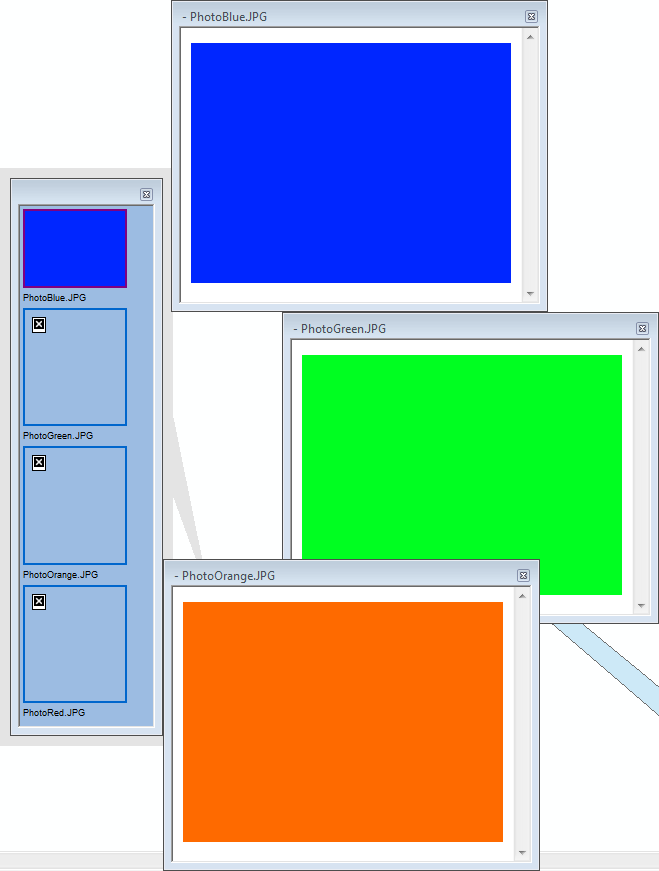

I am trying to use an XSL Template to allow our users to view multiple photo attachments held in a point feature class in a file GDB.
I have managed to successfully to get it to display them as a list, but only the first image is displayed correctly, the others appear as missing image symbols. But if you click on any of them they correctly load the attached image as seen in the image below.
Here is the current XSL Template I am using;

MarkBockenhauer
Owain,
In the HTML Layer properties, make sure you check "Download attachment data"
Mark
MarkBockenhauer
Owain,
Mark
OwainCatton
Cheers Mark
Brilliant that's was all it needed, I swear I had tried turning that on and off before.
Owain
