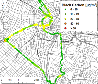

I have air pollution measurements taken throughout cities along bus routes that I need to display on my maps with the data aggregated into set distance segments. Right now when I map the raw data I have points throughout the cities from data collected every 10 seconds. Is there a simple tool I can use that will take the median and/or mean value every 100 m, for example?

No they're not currently spaced any set distance, they were collected every 10 seconds so the spacing is quite random. I don't need a rolling median, just a single median for every set distance. Essentially I just want to clean up my map (picture below) so that it's not just a blur of points. I know some people I worked with go along and draw fixed length polygons the entire length of the route and then join the points to each polygon and find the median value that way, but surely there has to be a more simplistic method because drawing out polygons for an entire city is no simple task.

 Sample Map
