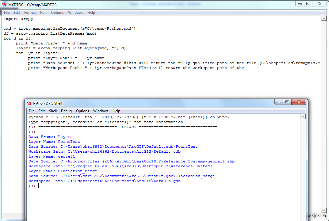

Hi Yoshi, you are on the right track for running the python command in the MXD. If you open the Python window and then paste each line into the python window, you should see the following output. The only change that you would need to make is to set arcpy.mapping.MapDocument() to arcpy.mapping.MapDocument("CURRENT"). This will set the mxd in Python to match the current ArcMap session. The output results should print in the same window you are working in.
If you want to run this outside of ArcMap, we can use a program called IDLE which is installed with ArcGIS.
1. To get to it, go to the Start Menu > All Programs > ArcGIS > Python 2.7 > IDLE (Python GUI). This should open a new Python shell window.
2. From this window, click File > New. Paste the entire code into this window.
3. Change the path of the MapDocument to match your MXD.
Example:
mxd = arcpy.mapping.MapDocument(r"C:\Temp\Python.mxd")
*make sure that a lowercase "r" is used before the path
4. Save the Python file
5. Click Run > Run Module
6. All the results will be printed on screen
Both of the methods are acceptable for running this script. Just remember that in the script provide, you can delete any of the print statements that you don't want to see on the final output.
