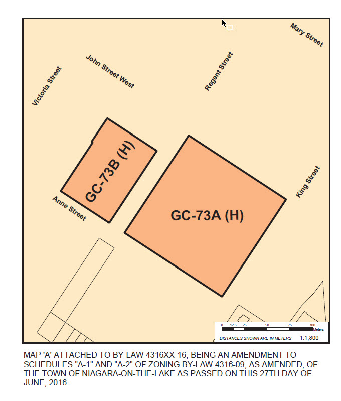

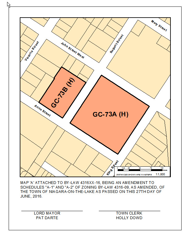

Screen capture of what it should look like:
This is what I get after trying to export:

I tried that about three times.  No luck.   The part that glitches in the export is when I try and colour the polygons.  The colour I choose seems to overtake the entire dataframe and not the polygon.   Something is really wrong in the program as all previous versions worked before 10.4.   I really need this to work as these schedules I prepare are for official documentation and I may have to resort to reinstalling an older version?  What were the fixes you mentioned?
