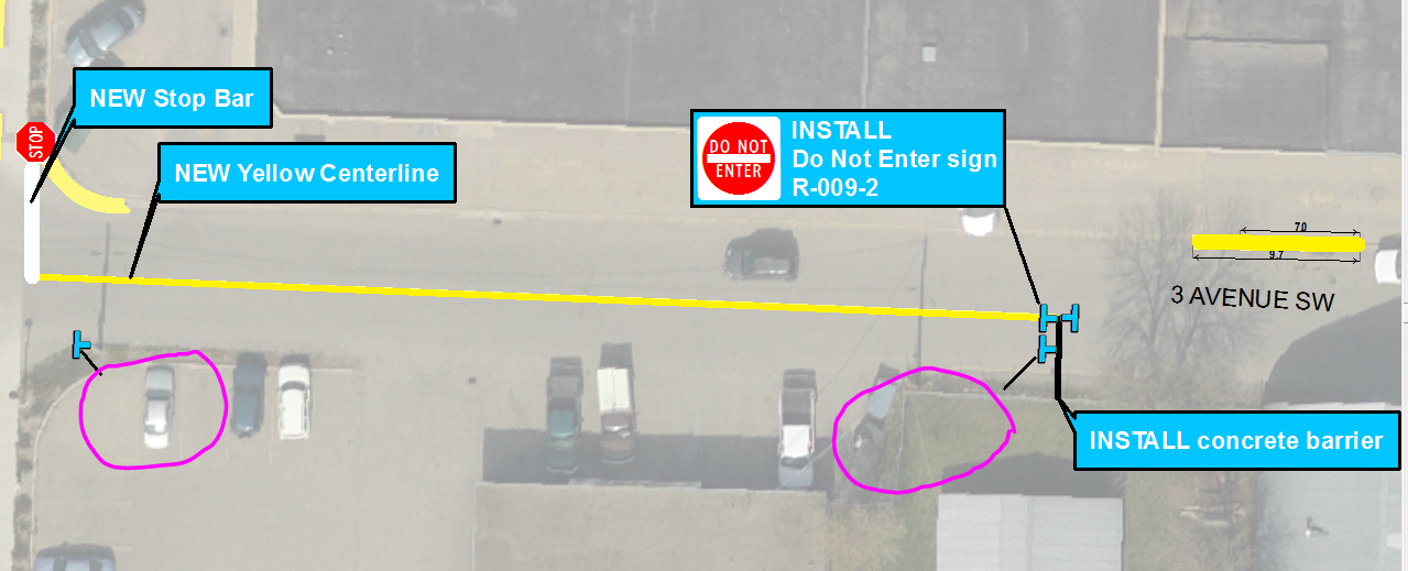

I am having an issue with my graphics/text in data view. I'm wondering if anyone else has had this problem. Please see the images below.
I had made 2 groups of text and marker symbols like the 'Do Not Enter' one in the first image below. I made them by creating a multi-layer marker symbol, creating text, and then grouping them together and adding a frame and background.

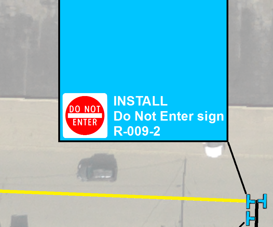

When I zoomed in on them in Data View, the frame would look like this:
It appears just fine in Layout View.
