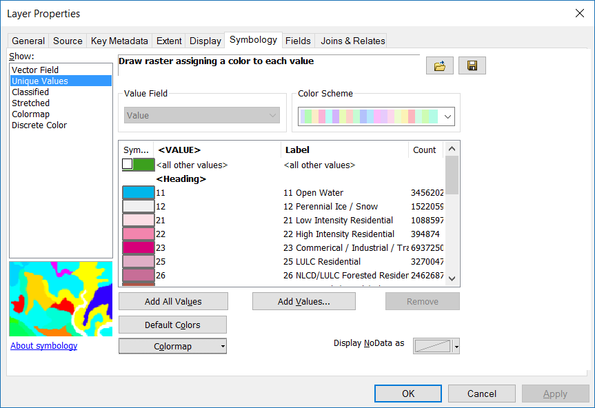

This is a classified image with a lyr file. So I exported the colour map to a clr.

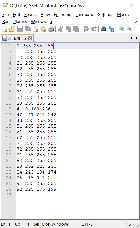

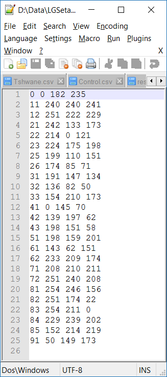

the clr file looks like this (its just text so open it in any text editor):

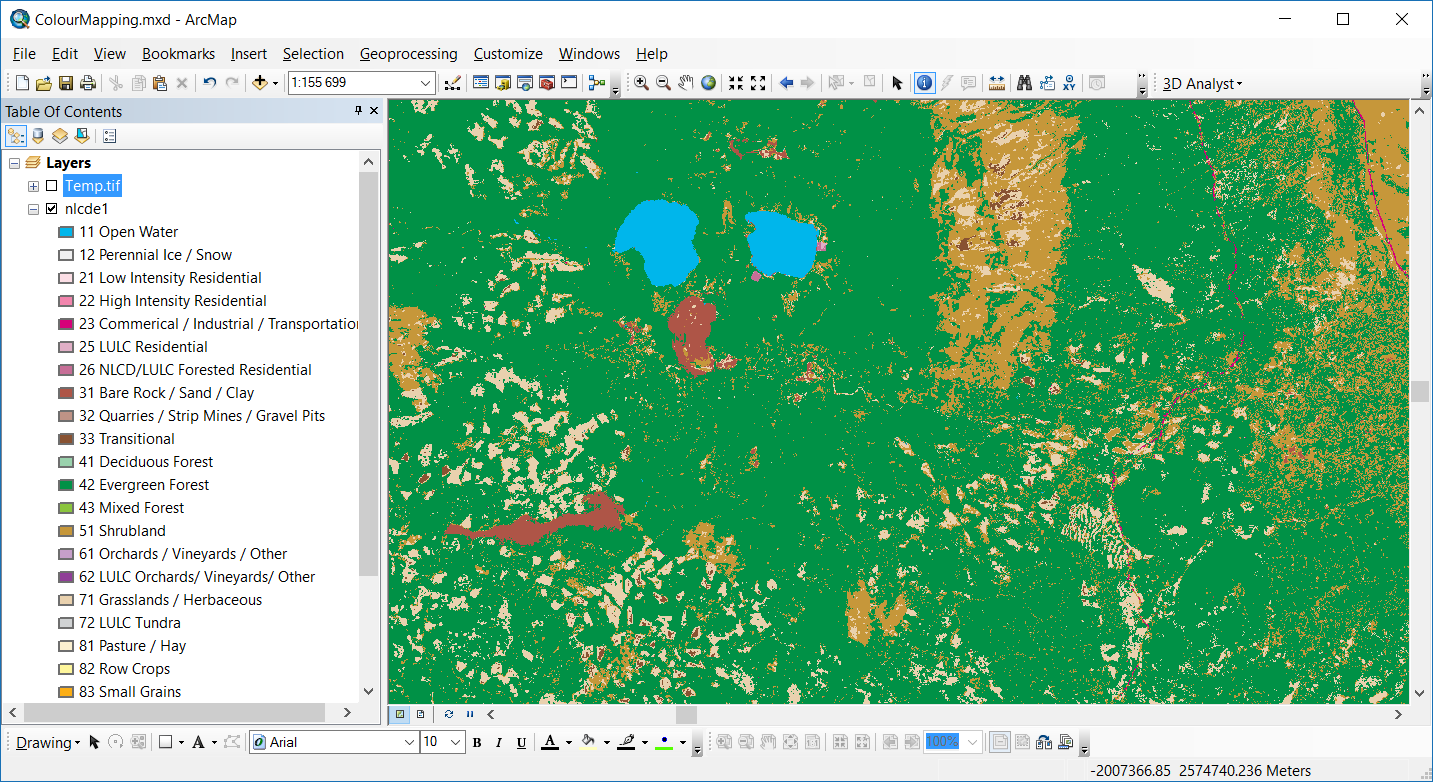

And in ArcMap the colours look like this :

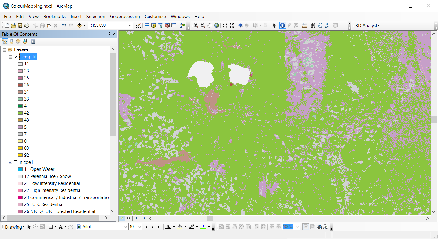

But when I clip a small portion out of this image, and re-apply the colour map I have just exported, the colours look like this :
So, what are the "r,g,b" values in that colour file.
If I use a colour picker on the web, vals 240, 240, 241 (Code 11 - Open water) is indeed a whitish shade, not blue as in the original.

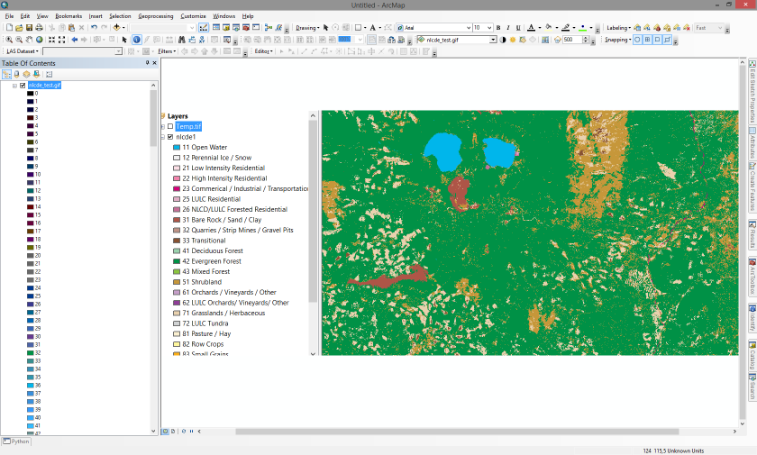

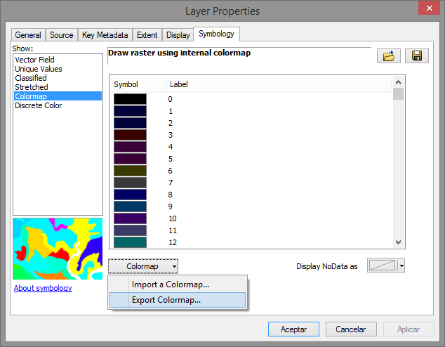

Strange... If I load a GIF (single band) version of the screenshot with the initial color to ArcMap:
and I identify the water, it shows me value 36:

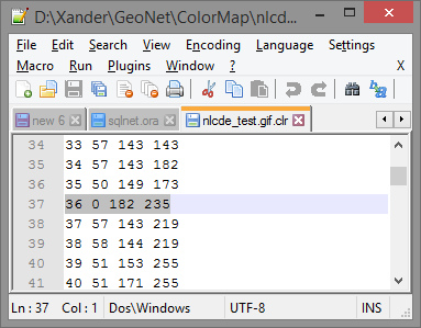

Exporting the colormap to a clr file:
and checking the RGB values for value 36:
It matches exactly to the color:

I loaded the image via a lyr file which was supplied from the image (the data source just ha to be re-set).
So I exported the clr from the Unique values renderer.
If I change this to the Colormap renderer, I see this whole list 0 - 255, with the actual colours, about 25 different ones, the rest are all 255, 255, 255.
I apply, of course all the labels have now been lost.
Then I export that one to clr, to get this :
Only the first 26 (which is probably how many colours I had in the first place) are exported.
But most of these are 255, 255, 255.

The RGB values in the .clr file correspond to the actual RGB values of the colors in the raster. Also my exports have the same content. No problem here. Can you attach a .lyr file of the original raster that presents the problems?
curtvprice
MVP Alum
What may be going on here is confusing the .lyr file using the unique values renderer (which ignores the colormap, it only works with the raster values - not the rgb values) with displaying rgb values directly from the colormap.
The way to get your clipped version to look the same with the nice classified legend would be to open the layer symbology tab, choose unique values, and import the symbology from the .lyr file we published with the data, or copy the original ArcMap layer and redirect its source to the new clipped .tif file.
