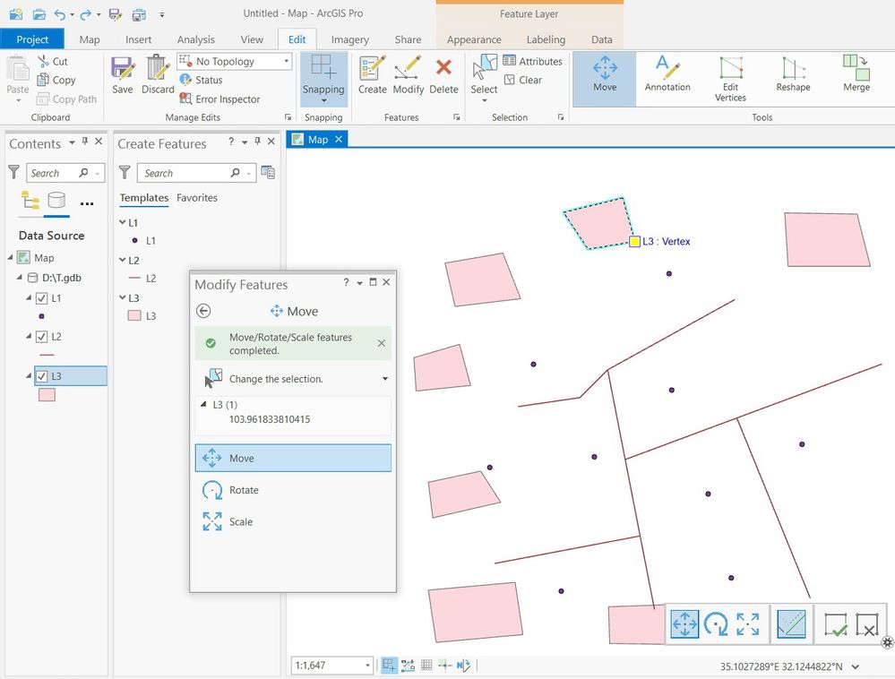

JamalNUMAN
Legendary Contributor
In Pro, the anchor point is indicated by yellow point. The same approach can be used to move the anchor point (ctrl + hover over then drag and drop)
