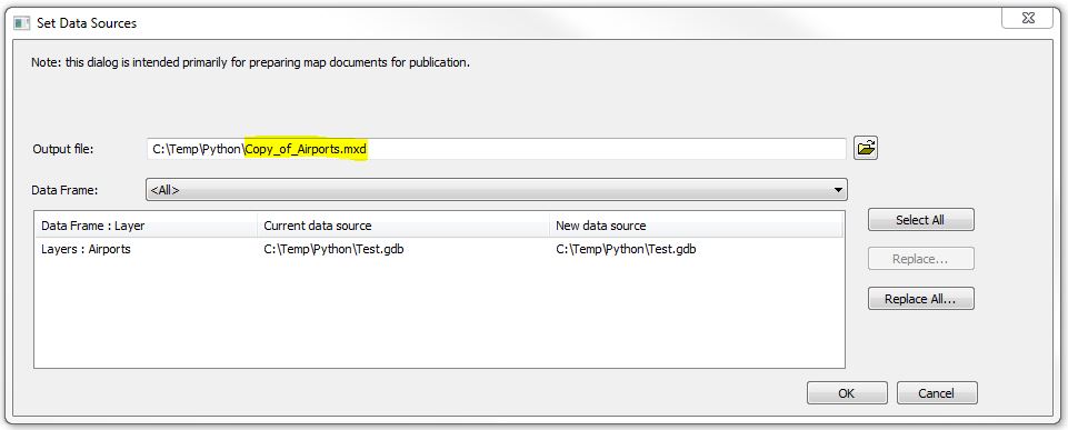

You can set the data sources to the new geodatabase by right-click on the MXD in the catalog window > Set Data Sources.  By default, this will create a copy of the MXD:
Just rename the output to the same name if you want to replace the existing MXD.  After setting the data sources to the new geodatabase, see if the MXD will open successfully.
