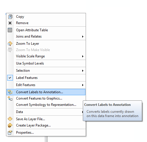

Start with converting label to a geodatabase annotation.
Then Export it to CAD.

maybe you don't follow  Jayanta Poddar Champion  steps well.
Frist create multiple labels in ArcGIS.
then convert labels to annotation ( GIS annotation not CAD annotation).
use the Annotation layer to convert it to CAD Annotation.
Export To CAD—Help | ArcGIS Desktop
I hope that clear Jayanta  suggest .

Yup...I got that to work.  Thanks for the help.
