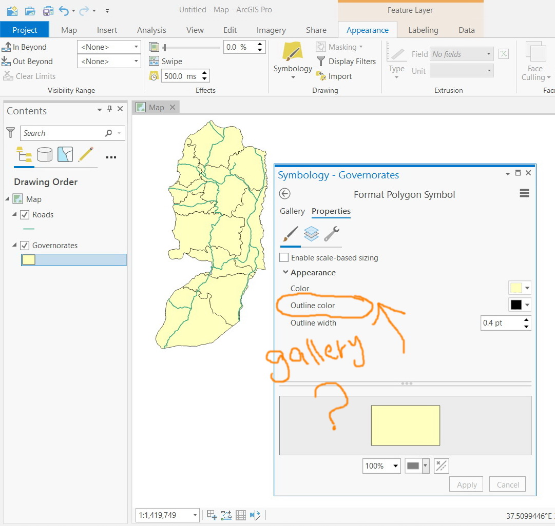

This should be simple, but I couldn’t figure out how to approach the gallery for the outline of polygon layer. I assume that I can approach the same gallery available for the line layer while I’m working with polygon

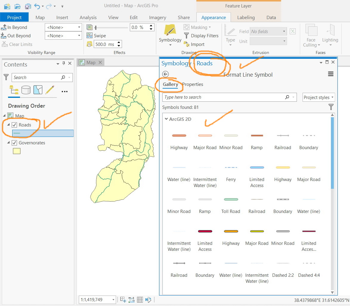

Jamal - if I understand your question correctly, in the second graphic the UI is on Properties for the polygon symbol.  Click Gallery to the left of Properties and then you see the Style Symbols (gallery).  Is this what you're asking?

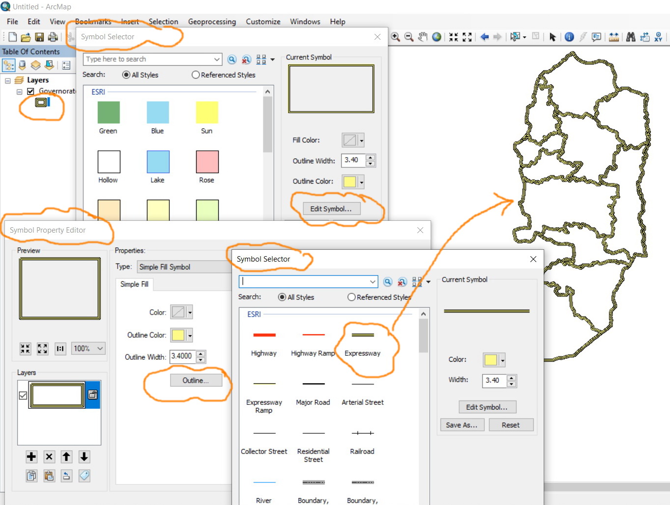

I’m looking to something equivalent to what is used to be available in ArcMap shown in the screenshot below. I need to select a style for outline of the polygon.
