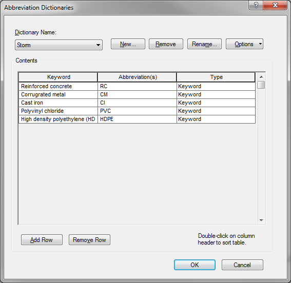

I am trying to label utilities. I am using Maplex and have created a dictionary. When I go in and engage the dictionary thru properties etc..click apply and refresh etc... it does not change to the abbreviation.
Any ideas!

Post your dictionary.  Area you completely replacing words with abbreviations?

I am completely replacing with Abbreviations. This is a short list just to see if it would work

Change all from Keyword to Translation. Then in the Layer Properties -> Placement Properties -> Fitting Strategy Tab -> Check Abbreviate Label -> Choose Option -> Select your dictionary from the list.
Once dictionary is selected;  Again in Fitting Strategy Tab -> Strategy Order (button at the bottom) -> Move Abbreviate label strategy to the TOP OF THE LIST.

Still didn't work. Is there something I am not seeing! I tried exactly how you put it a couple different times!

Not really sure what else could be causing this. I can only suggest going back to the drawing board to test this in a new map this particular features a the only layer in there; Unchecked all strategies except for the abbreviations.  Ensure you click Apply in the layer properties after you make any change in there - clicking OK does not commit any changes.
I can confirm that the data dictionary works well in version 10.0, 10.1 and 10.2 but i have not tested in 10.3

I went back to the beginning, even looking at the
script in the label expression. I revised it and went thru And reattached
everything and it worked!
