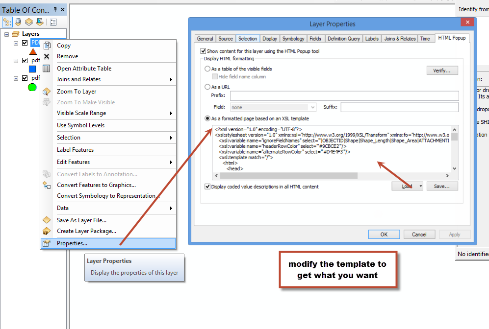

If you are working within ArcMap you can use HTML popup properties on the layer with and XSL template to achieve what you desire.

Yes,  I put an example here  http://www.arcgis.com/home/item.html?id=1a4d6680918b461e9effbff413536c22
There are two layers,  One shows a pattern for linking to the local file, the other shows the picture in the popup.
The example uses a picture named 'IMG_9822.JPG'  The picture is located in the C:\Users\Public\Pictures folder on the computer.
I loaded the default XSL Template  (click the Load button)
I then added this to the <xsl:template match = "Field"> section  in the <xsl:choose> part.
Link to picture
