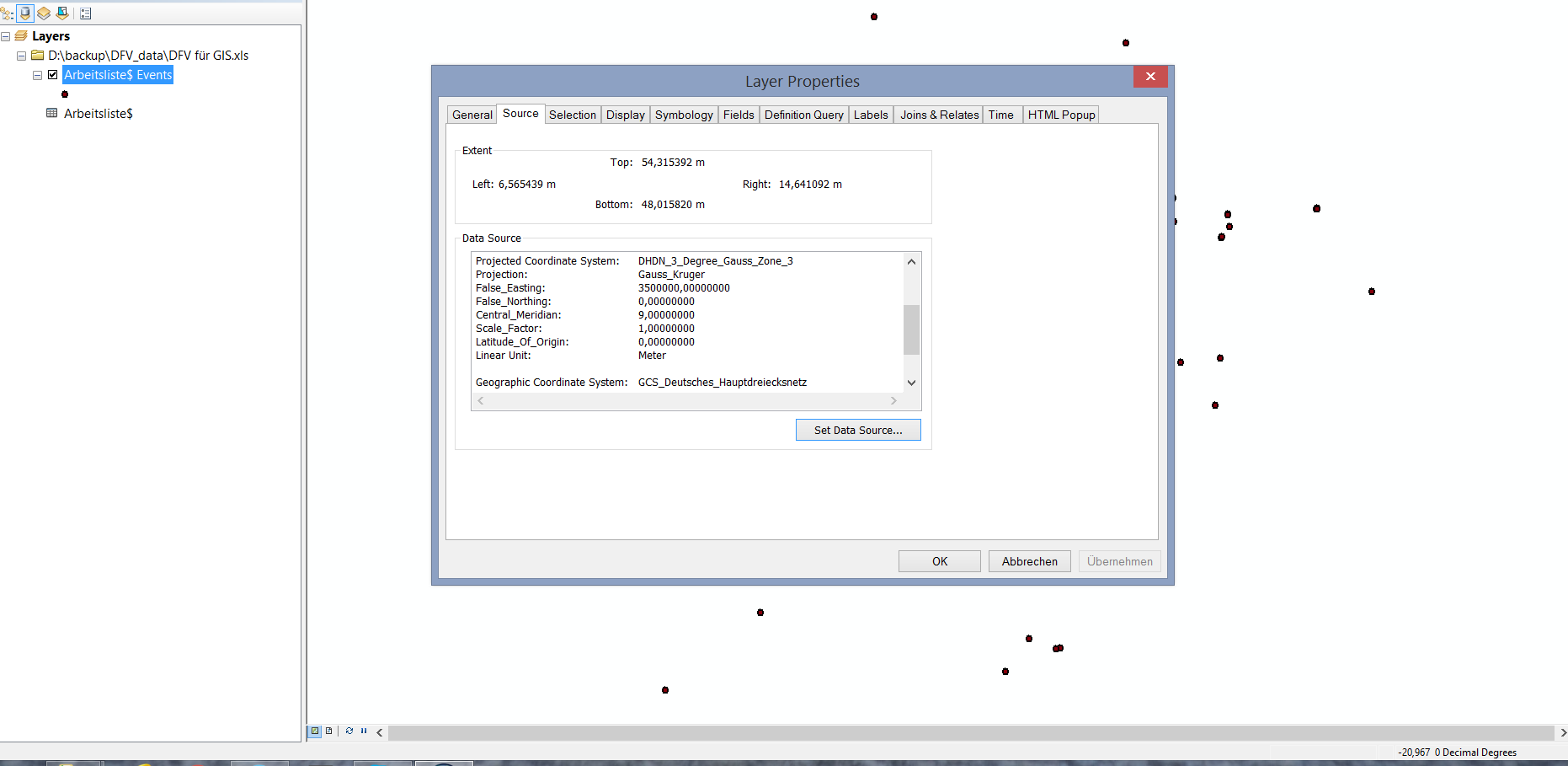

Hello everyone, I was making point data from xls/csv file. But i want to project my data into a Projected coordinate system, not in GCS. As this data is from Germany, so I was trying to make it into DHDN Gauskruger 3 zone 3, but unfortunately this is not working and the dataframe unit is showing decimal, see the attached image bottom right corner. I tried with ESPG 1989 33N also but its same. Any idea?

You have to Define Projection first... telling it what it is, not what you want it to be.
Once it is defined, you can use the Project tool

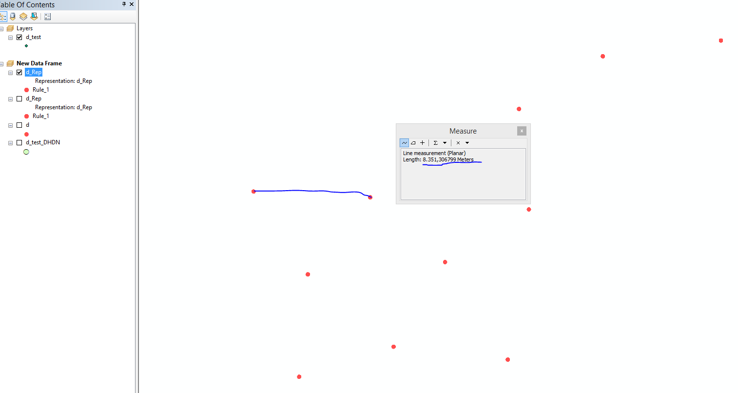

Muqit_Zoarder
Hello Dan, I am facing trouble to make the disperse locations of similar lat/long values. My projection unit is in meter, I put 1 meter as parameter, but the points are creating at distant locations like 10km or 12 kilometer away, please see the image. I need to view the point markers just beside the actual point.
TieshengWu
What's your  original x,y data like?  May be you have lon,lat data, but you difine it as projected coordinate (I see you have 0 degree latitude in your map) ?
Muqit_Zoarder
Hello Wu, thanks, but i have solved that projection issue. But I cannot create the disperse markers correctly , now points (markers) are creating distant place, like 12 km away from actual place. Any solution?
TieshengWu
Do you know the original long/lat's coordinate system?  Maybe the data's GCS is not Deutsches Haupt...    .  can it be WGS84?    There is several hundred meters of diffrence between them. Ask the data provider or try other GCS, and maybe it's not nessasery to change it to projected coordinate.
NeilAyres
MVP Alum
But that's why we think you have an incorrect original coordinate system
TieshengWu
May you post some of x,y data?
NeilAyres
MVP Alum
Exactly as Dan & Wu says.
Judging by the extent values in your original post, your input points were in some form of GCS (lat/long), but they have been defined as the german grid metres.
This is a mistake. Bring the points in a define them correctly first, then project.
Muqit_Zoarder
Hello Neil, thanks, but i have solved that projection issue. But I cannot create the disperse markers correctly , now points (markers) are creating distant place, like 12 km away from actual place. Any solution?
