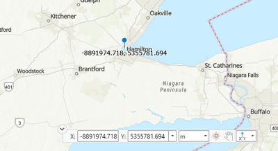

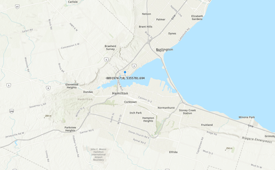

BojanŠavrič

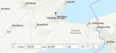

I set my map to Web Mercator (3857) PCS and then I used Go To XY tool and I input your projected coordinates above, by changing units to meters:
By setting units to decimal degrees, I get the same point with geographic coordinates above:
