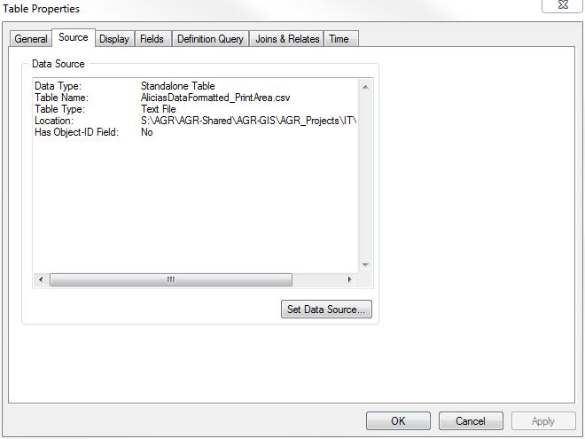

I'm trying to master the wretched process of dealing with unidentified coordinates. I work for a state agency that does a lot of field work and this data comes in fairly often. I'd like to train my users on how to manage it, but it appears I haven't quite got a handle on it myself! This is the documentation (unless one of you knows a better source).
29129 - Identify the spatial reference, projection, or coordinate system of data
It says to add the data table and look at the data via the 'project on-the-fly' utility.
But when I look at the source tab, I can't see anything but text, both with a csv or xls table.
I wondered if maybe it was b/c it wasn't a dbf but when I try and export as a dbf it fails! Help, please? TIA

cool idea. I work for the State of Vermont so that might be doable. I still don't understand why this data can't be viewed in my source tab like the documentation says. I'd just like to do it the right way!

The coordinate systems are all based on NAD 1983 (state plane on NAD27 would have different values). The 2nd column is either a x/easting/longitude value while the third column is y/northing/latitude.
They're just a sample coordinate pair per each coordinate system (one geographic, two projected).
It's xy file data, so the same information isn't as available as it is in a shapefile or other feature class.
