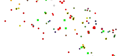

This is what I came up with after reading both responses.
Shapes are city departments, colors are issue types. I'll need to try different colors for the accessibility side as this was just a quick prototype to test the service within the viewer app (using Javascript SDK directly, not ExB).
