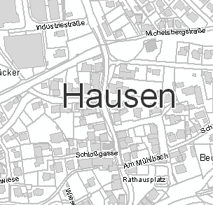

Hi all,
I came across this issue regarding labels overlapping annotations in ArcMap 10.6 (picture left) where they don't overlap in 10.5 (picture right)... What am I missing? I simply opened the mxd so the settings are all the same (I would have guessed, but obviously I'm wrong):
How can I prevent the labels from overlapping annotations in 10.6?
Thanks for any help!

LindsayWithers1
We also ran into this same problem with 10.6. Previously (pre-10.6) we would sometimes see this if the "Default" annotation group was turned off, but now we see it happen even when the "Default" annotation group is still turned on. We noticed that some label settings within existing maps/mxds changed automatically when we switched to 10.6 (such as: Remove duplicates changed from 0 map units, to 5 inches), but even when re-adjusting that setting we still see labels overlap sometimes.

LindsayWithers1
Thanks Wendy! Our annotation setting has been at High by default but that hasn't solved the problem we're seeing. Another odd thing that started happening at 10.6 (for existing maps where everything had been working fine in 10.5), is that if we set a polygon layer's label weight to 1,000 (for both boundary and interior, with all other layers at 0 weight) so that no labels draw over that polygon, some labels still draw over that polygon. So we've had to use SQL queries a lot more to not have those labels not draw over certain polygons since opening up our maps in 10.6. Is 1,000 still the correct number to use to stop any auto-labeling to occur over a feature?

LindsayWithers1
Thanks Wendy! And nope, the label classes have "Never remove" unchecked. Attached are a couple screenshots showing the difference between the same map (created in older version of ArcMap) after being re-opened in 10.6. We were using a polygon layer (with 1,000 weights) to stop labels from drawing outside of a study area. 10.510.6
