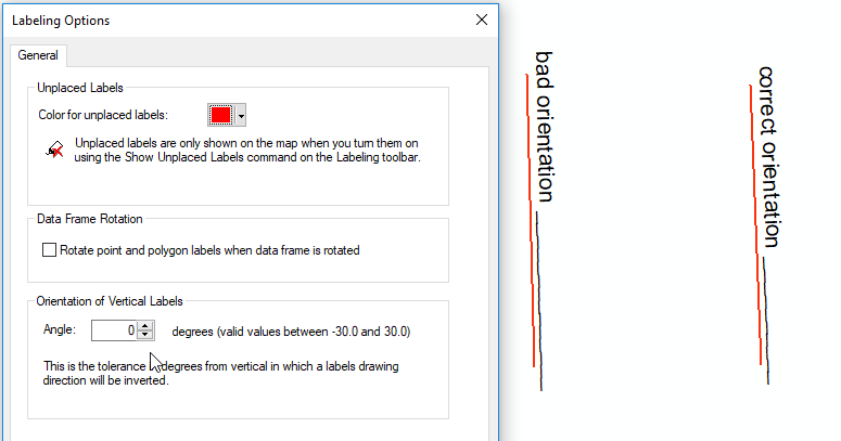

Hello,
I have a problem with the labeling from ArcMap 10.4.1.
In the attached screenshot you see a label to a polyline. As you see, it appears on the left side. According to the ruls, it should be "above" the polyline, but it apears on the left (below).
The map is not rotated, and the coordinates clearly show, that the line is displayed well.
My issue with this, is that the text of the label describes content of several lines (see sample screenshots) and the order actually matters. Our code calculates the angle of the poyline orientation, and then decides, how the text should be filled. This code works well, but then this problem causes to show the content in a mirrored way.
Can someone tell me the "rule" by when the text is placed corretly ?
Lionel
WendyHarrison
Hi Lionel,
Thanks for sending the data.  It looks like you'll just need to change the Orientation of Vertical Labels Angle.
To get there - click Labeling on the Labeling toolbar > click Options > change the Angle to 0
You can read up on this option here - About the general label settings—Help | ArcGIS Desktop
Let me know if you're still having issues.
Wendy

LionelMartz
Hi,
unfortunately there is no blocking feature causing this. it also happend without any other feature.
I've tried maplex, and this looks well, but unfortunately we work with an ArcGIS Engine software that does not support Maplex yet. But it helps us, when moving map later to ArcMap, so thanks for that tip!.
I also thought about coordinate system issues, but everywhere are the same.
I reproduced it in some small shape file, which I've append here together with mxd.
Thanks
Lionel
WendyHarrison
Hi Lionel,
Wendy
LionelMartz
Thanks, that was the solution!!
