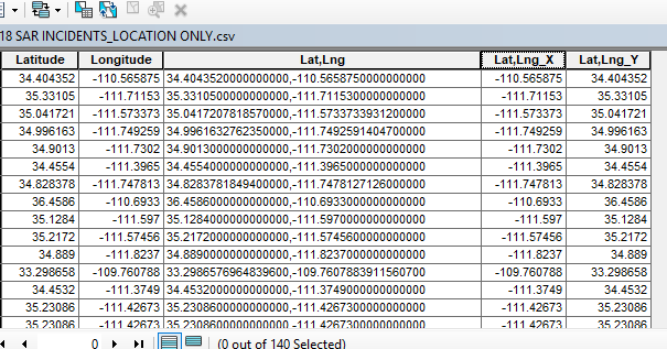

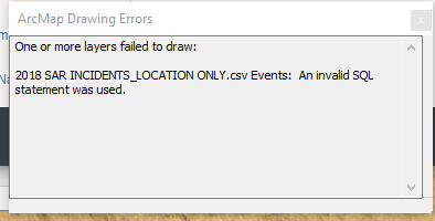

I am trying to add some point data to my map the coordinates are in a valid format.  Each time I try to convert the .csv file data using the display x/y data I get this error
I have tried using the first two columns and the last two columns as my input data.
The "Event" is created in the TOC but the attribute table has no data in any of the fields.  I have another map I created using similar data and my point conversion and resulting table was populated and the points displayed properly.
What am I missing?

In the image you posted, those coordinates are NAD83 (geographic coordinate system, decimal degrees) and not in State Plane. Try defining the coordinate system as NAD 1983 (North American 1983) instead.

Okay,  I found a solution to the SQL statement error.  One of the attribute fields was using a ","  and ArcMap doenst like that.  So I corrected this and got no pop up.
My points got into an "Events" format the table data looks fine but my points are still not displaying.....

Once again superGIShero  has saved my day      I changed to NAD 1983 and the points are there.  How did you determine is was NOT in NAD 1983 State Plane format?  What do I need to look for?

By coordinate size. Decimal degrees runs x/longitude +/-180 (or maybe 0 to 360) while y/latitude is +/-90. There's just about no projected coordinate system that uses that range unless you're mapping a building or playing field and using a custom definition centered on the object.
I don't know what's happening with the no attributes or the error on export. It sounds like there's still problems in the spreadsheet. Double-check the column names and look for leading/trailing spaces in the names too.
