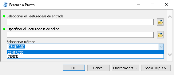

In case you do not have access to an Advance license you could create a tool that does this for you with a Basic license.(sorry for the Spanish interface)
  • first parameter is the polygon featureclass
  • second parameter is the output point featureclass
  • third parameter is the method
The code beneath looks like this:

    main()
