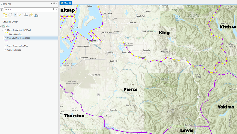

It's a good question and there probably isn't one "correct" answer.  I lived in Seattle, WA when I got my graduate degree in GIS, so a lot of the data we worked with was from Seattle and King County which uses Washington State Plane North.  However, I worked in Tacoma at the time, and when I used Tacoma/Pierce County data, the standard was to use Washington State Plane South.  Perhaps this is a "classic" example as it is included in this wikipedia topic: https://en.wikipedia.org/wiki/State_Plane_Coordinate_System

If that isn't the case, and you have determined that you need to use a State Plane coordinate system, then it will be more accurate to use the coordinate system that covers the largest extent of your data.
