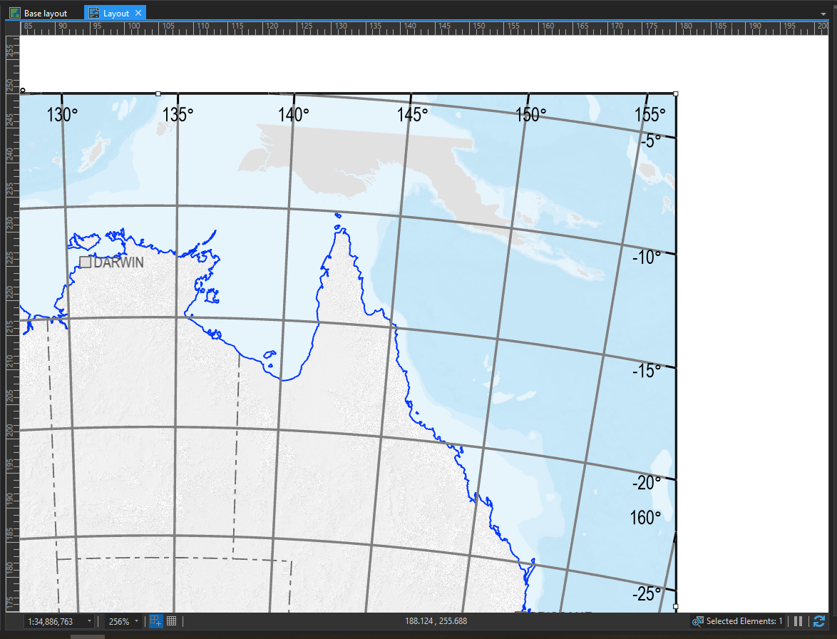

Hi All,
I have an issue, where I am trying to avoid dropping my grid to a graphic element and manually aligning the Lat/Long labels to the grid lines. The projection that we are using means that the grid lines are curved, and across the continent of Australia the angles can be significant in the lower latitudes. I have attached a screen cap of a sample map if anybody is having trouble visualising what I mean.
Is there a way that the labels can be aligned via arcade? (or is there a setting that I'm just not seeing).
We have Pro 2.4 deployed, however I believe that an upgrade is in the works.

Hi @DanielMcIlroy ,
A bit of a late response but thought I'd try anyway...
The angle of your latitudes is changing as you go east-west, so the only way I could see to sort it out dynamically is:
1. Get a feature class of the grid.
2. Split the lines at grid intersections
3. For each line calculate or manually add the bearing you want the labels to be in a 'rotation' field
4. Set the field as rotation value of your labels.
For longitude lines the angle stays the same throughout for each line, so you don't need to split them, just add the rotation value you want in the table for each longitude.
Hope this helps,
Uri
