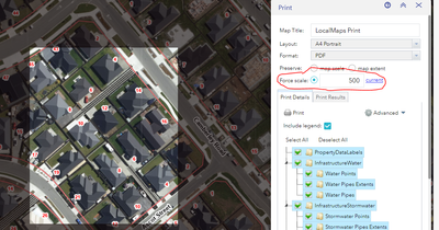

TerryOD
There's an option in the print widget for the user to force the scale when exporting to a fileTerryOD_0-1684891397883.png
Or via URL parameter but this still only zooms to the nearest scale level of the underlying basemap, format is something like
&center=1614361.675%2C5423962.21%2C2193&scale=10000
I'm not sure of any other way unless you had those scales in your basemap cache, or you had no basemap in the webmap at all (we used to be able to do that on the old viewers, but not sure if that is possible these days?!)
