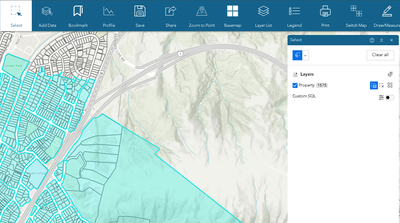

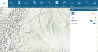

Hi @TaupoDistrict_Council. Just came across this requirement and would like to provide an update around this.
In 3.1, you can achieve this by selecting the layer you want to query against and selecting by drawing a shape (rectangle, circle, etc.). You can then apply clauses to highlight the features which meets the criteria. Does this address this requirement?
E.g. In the images below, I have selected the properties in the map through the select widget. Then I applied a clause to highlight the properties that have a certain ID. In the second image, you can see the property is highlighted based on the criteria.
