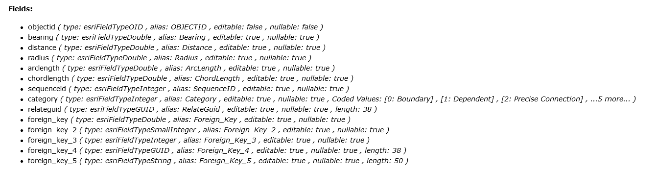

I deployed the Parcel Drafter solution via ArcPro and am trying to get it set up.  Is the list of snapping layers expecting an actual Parcel Fabric feature that has been published?  When I try to add the published version of our PLSS control points, for instance, I get an "invalid foreign key" error, leading me to believe that perhaps it's expecting a very specific schema and not just any old layer.

ChrisBuscaglia
Yes, this is strange - does the line feature layer have a relateGUID field?
  • OBJECTID (type: esriFieldTypeOID, alias: OBJECTID, SQL Type: sqlTypeOther, length: 0, nullable: false, editable: false)
  • Bearing (type: esriFieldTypeDouble, alias: Bearing, SQL Type: sqlTypeOther, nullable: true, editable: true)
  • Distance (type: esriFieldTypeDouble, alias: Distance, SQL Type: sqlTypeOther, nullable: true, editable: true)
  • Radius (type: esriFieldTypeDouble, alias: Radius, SQL Type: sqlTypeOther, nullable: true, editable: true)
  • ArcLength (type: esriFieldTypeDouble, alias: ArcLength, SQL Type: sqlTypeOther, nullable: true, editable: true)
  • ChordLength (type: esriFieldTypeDouble, alias: ChordLength, SQL Type: sqlTypeOther, nullable: true, editable: true)
  • SequenceID (type: esriFieldTypeInteger, alias: SequenceID, SQL Type: sqlTypeOther, nullable: true, editable: true)
  • Category (type: esriFieldTypeInteger, alias: Category, SQL Type: sqlTypeOther, nullable: true, editable: true)
  • RelateGuid (type: esriFieldTypeGUID, alias: RelateGuid, SQL Type: sqlTypeOther, length: 38, nullable: true, editable: true)
  • Shape__Length (type: esriFieldTypeDouble, alias: Shape__Length, SQL Type: sqlTypeDouble, nullable: true, editable: false)

ChrisBuscaglia
Can you please send me a screenshot of your rest endpoint showing the fields as shown above?  What DBMS are you using, oracle?

ChrisBuscaglia
Angelo,
I think that you uncovered a bug, the widget may be looking for a camelcase "RelateGuid" field in the lines layer - instead, Oracle DB is changing it to be relateguid - all lowercase.
Using the AGO Assistant - you can manually change the name of the field in the application json.
ArcGIS Online Assistant
Data Section -
"relatedGUID": {
"name": "RelateGuid",
"type": "esriFieldTypeGUID",
"alias": "RelateGuid",
"length": 38,
"editable": true,
"nullable": true
