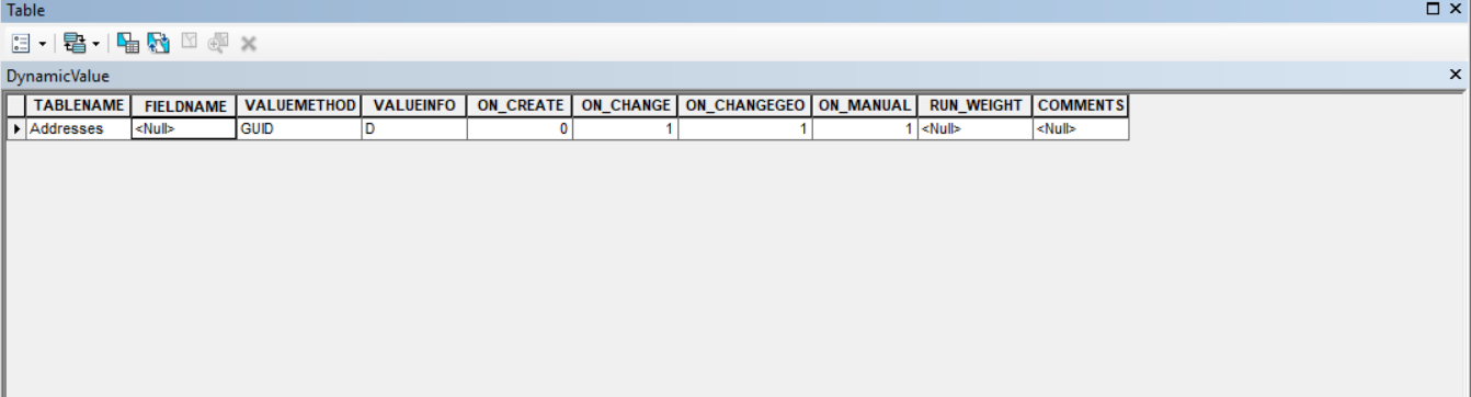

I am having trouble using AA for creating GUID. Below is the snapshot of a DynamicValue table:
I have turned on debug mode and below is log file record:

Is FIELDNAME supposed to be <Null>?

no.  type the name of the attribute field that will have the GUID data.
In our case, the attribute field name is called, "sdsID" or "GlobalID"
