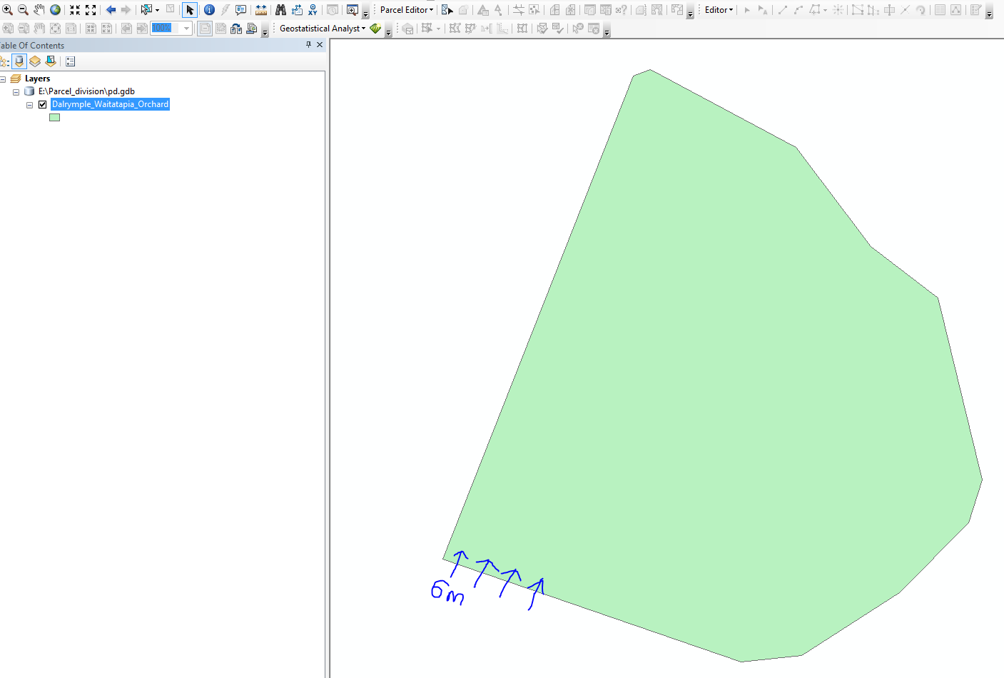

How to split a polygon into strips with equal width
3493
10-14-2016 09:31 PM
GoldenJiang
Deactivated User
I want to split a polygon into strips with equal width but I got stuck by the Parcel editing idea: arcgis 10.0 - How to split a polygon into multiple equal-width polygons in ArcMap 10? - Geographic I...
I can't open Parcel Division to edit feature class so I must convert the feature class into Parcel fabric.
But I am not sure how to do this.  Can anyone point out a right way?

anna_garrett
You would need to import your feature class into the parcel fabric. Load data to a parcel fabric—Help | ArcGIS for Desktop would be the a good place to start. The videos here are also very useful. This would be a decent one to start with, I think:  Video Link : 3550
After you have all your data migrated into the fabric, you can use the parcel division tool.
