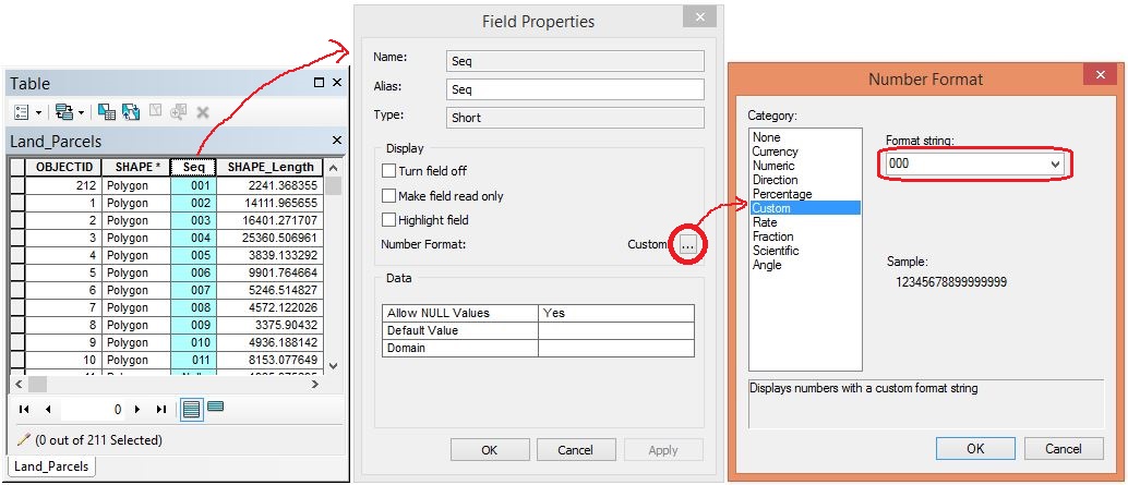

Mohamed_MagdyMohamed_Hussain
Deactivated User
You can change the format of the numbers in Attribute table of the feature by open field properties then in number format click [...] button then choose "Custom" in format string put "000" that make the number in 3 digits
SunilChandekar
Deactivated User
It worked... thanks a lot Mohamed...
