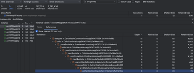

Also, what I've found in the other project is that ArcGISMap seems to be leaking inside NetworkAuthenticationInterceptor:

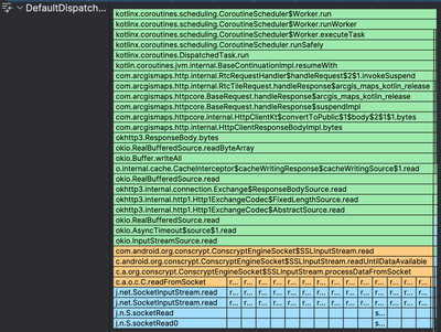

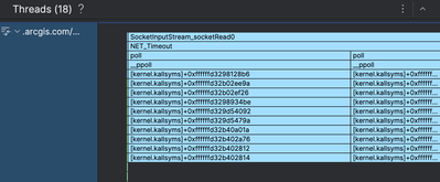

Also, it feels like reading tiles is done via DefaultDispatcher. As a result -> with bad connection default dispatcher is over-queued easily as it's not intended for long-running operations. If so, http tile reading operations should be switched to IO and asap.
dev4567

Heap Dump shows memory leak: several ArcGISMap instances are present (one inside the MapView, and others leak to own StateFlow internally.
We have implemented a stress test that rotates the device periodically over a long period of time. Based on this test, we believe that the additional allocations of the ArcGISMap that you are seeing in the heap dump are due to your code that uses `remember` to create an ArcGISMap:
val map = remember { ArcGISMap(Basemap()) }
 `remember` only caches the object across recompositions, but not if the composition is destroyed and recreated, as it is during a configuration change. This is the reason why you see multiple ArcGISMap instances, as they are allocated with each screen rotation. To ensure only one allocation is used, we recommend using a ViewModel to store the map.
Regardless of whether you use `remember` to store the map or a ViewModel, we have not observed any memory leaks in the memory profiler when running our stress test.
It is correct that network requests are initiated and processed on the DefaultDispatcher, however the requests are actually executed on a separate threadpool owned by the OkHttpClient. While requests are executing, the coroutines on the DefaultDispatcher are suspended but they are not blocking any threads. In other words, the behavior you are observing is working as expected.

1. Regardless where to store the  ArcGISMap (btw it's almost impossible to do so in the VM because of sdk's handler mechanism and "Object already owned") there should be no more than 1 instance after the rotation and GC call. Anyway, I'll try to reproduce once more with the new 200.5 – maybe, there is no issue anymore 🤞
2. I can't agree about the dispatcher: it doesn't matter much which thread okhttp works on if client's (your) coroutine is not suspended actually. As far as I remember Default dispatcher has limited number of active coroutines. And if calls with okhttp inside takes this limit, all other enqueued coroutines gonna wait in the queue – that's what we clearly observe if the i-net connection is really bad. If we switch sdk to IO dispatcher (via reflection) we see the issue no more. However IO dispatcher is elastic – meaning it could overwhelm the process with a lot of threads, so we end up using:
