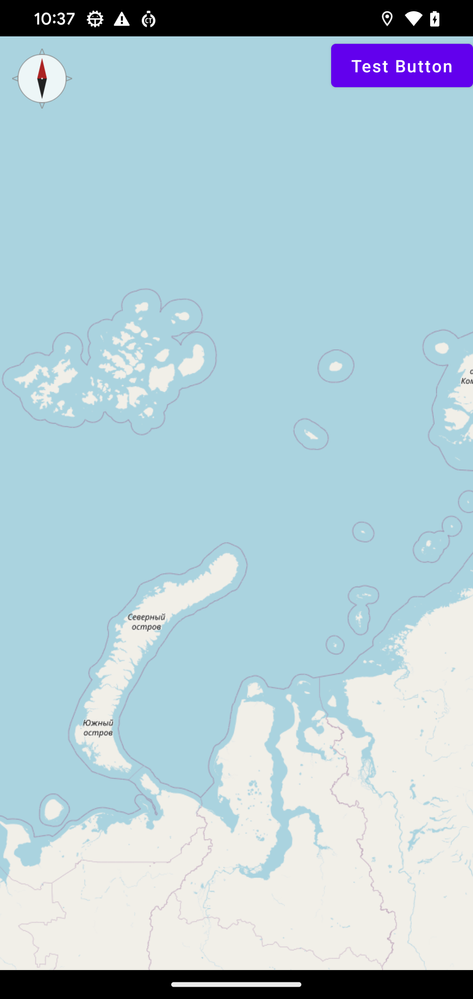

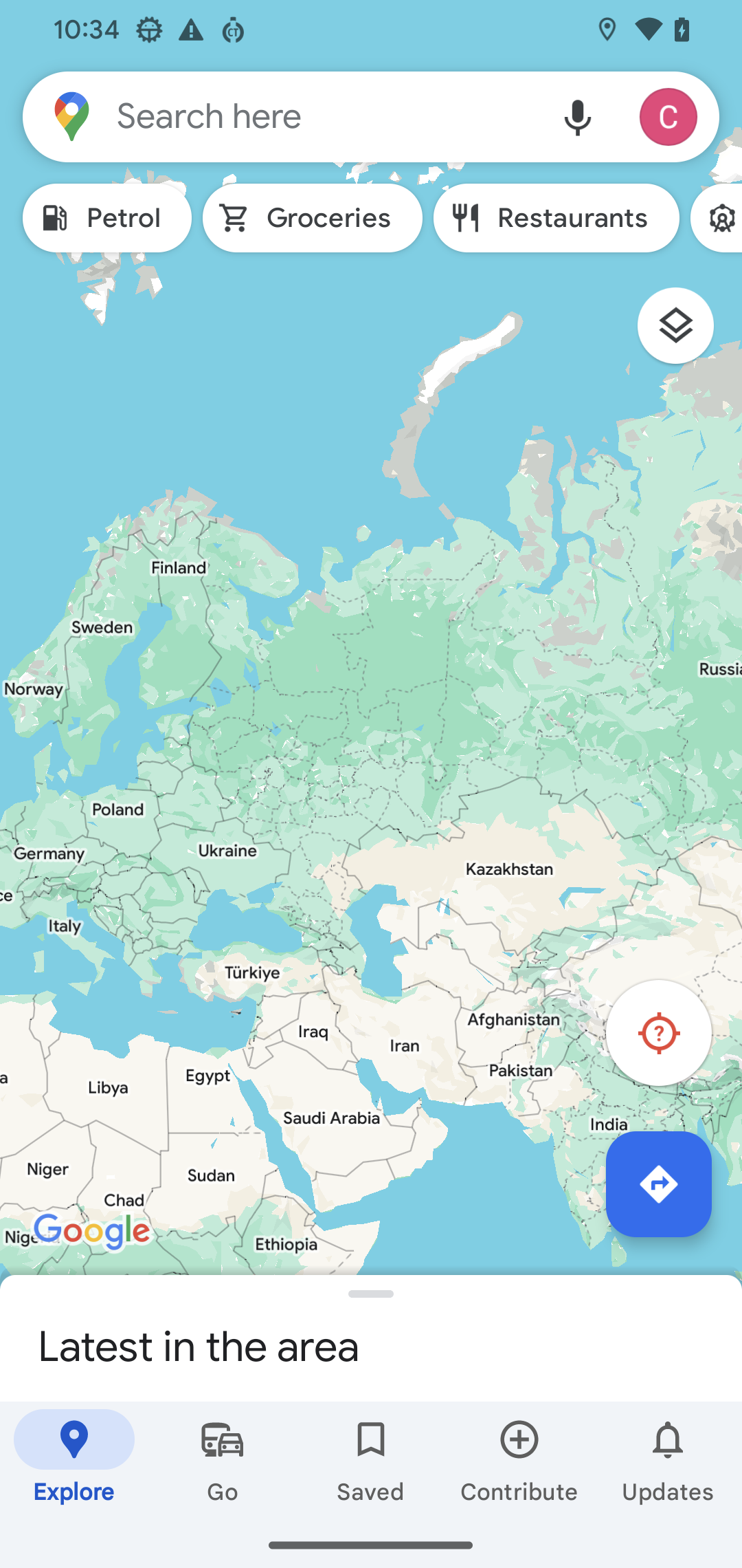

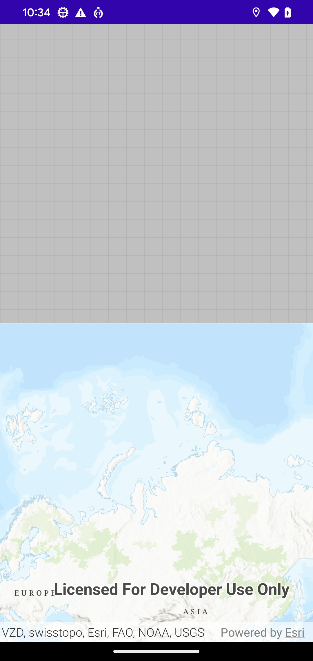

I want to achieve something similar to the images 1 and 2, a full screen world map with fixed min zoom/scale level. But with Esri SDK I find the MapView  scrolling beyond the actual map and show the background grid. How can I achieve something like that?

Thank you for the suggestion. I can set the min Scale and max scale. But the map still can be scrolled, and it will show the background grid by scrolling beyond the actual map image. If I disable the scroll when min scale is reached, still it can be scrolled beyond the actual map once you zoom-in and start scrolling. 😞
