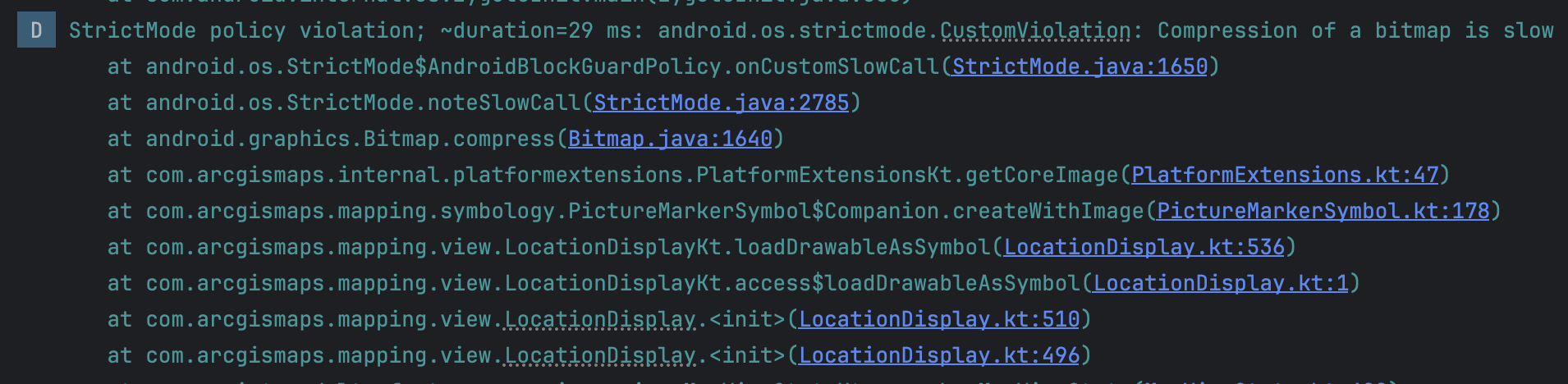

`StrictMode` policy indicates that `LocationDisplay` loads a bitmap in the Main thread and it's slow:
`android.os.strictmode.CustomViolation: Compression of a bitmap is slow`

Thank you @dev4567 for reaching out regarding this issue. I can confirm this would be a warning displayed when constructing the LocationDisplay with StrictMode enabled. We have logged this issue and will provide a fix in a future release.
Meanwhile, if you're looking for a way to resolve the warning currently, I would recommend creating the LocationDisplay while in a coroutine scope and not on the main thread.
