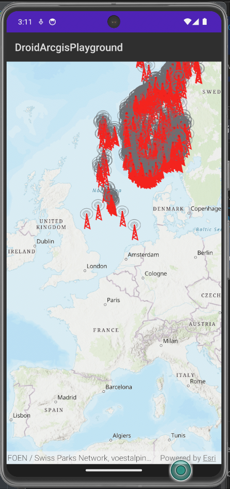

We try to load this layer
https://services-eu1.arcgis.com/mXUvYpmRuCvDyiRV/arcgis/rest/services/NRL_PointHigh/FeatureServer/0
It worked with SDK 100.X, but not on 200.X
Issue applies to Swift version to.
Old version 100.X do work

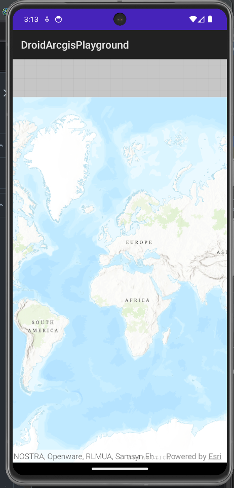

New version 200.X do not work
package com.example.droidarcgisplayground
import android.os.Bundle
import android.util.Log
import androidx.appcompat.app.AppCompatActivity
import androidx.lifecycle.lifecycleScope
import com.arcgismaps.ApiKey
import com.arcgismaps.ArcGISEnvironment
import com.arcgismaps.LicenseKey
import com.arcgismaps.data.ServiceFeatureTable
import com.arcgismaps.mapping.ArcGISMap
import com.arcgismaps.mapping.BasemapStyle
import com.arcgismaps.mapping.layers.FeatureLayer
import com.arcgismaps.mapping.view.MapView
import kotlinx.coroutines.launch
class MainActivity : AppCompatActivity() {
    override fun onCreate(savedInstanceState: Bundle?) {
        super.onCreate(savedInstanceState)
        ArcGISEnvironment.setLicense(LicenseKey.create("")!!)
        ArcGISEnvironment.apiKey =
            ApiKey.create("")
        val mapView = MapView(this)
        lifecycle.addObserver(mapView)
        setContentView(mapView)
        val map = ArcGISMap(BasemapStyle.ArcGISTopographic)
        mapView.map = map
        val table =
            ServiceFeatureTable("https://services-eu1.arcgis.com/mXUvYpmRuCvDyiRV/arcgis/rest/services/NRL_PointHigh/FeatureServer/0")
        val featureLayer = FeatureLayer.createWithFeatureTable(table)
        map.operationalLayers.add(featureLayer)
        lifecycleScope.launch {
            table.load().onFailure {
                Log.e("MainActivity", "Failed to load table", it)
            }.onSuccess {
                Log.d("MainActivity", "Table loaded")
            featureLayer.load().onFailure {
                Log.e("MainActivity", "Failed to load feature layer", it)
            }.onSuccess {
                Log.d("MainActivity", "Feature layer loaded")
snlasystem
I sometimes try to test with ArcGIS Runtime SDK Samples
https://apps.apple.com/no/app/arcgis-runtime-sdk-samples/id1180714771?l=nb
but this is still made with 100.X of some reason...

Hi,
There appear to be some discrepancy in the encoding of the symbols within the service, can you provide more info on how you published this service? (e.g. where did the symbology come from? e.g. the version of ArcGIS Pro did you use to publish?)
Thanks
Mike
