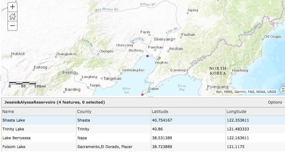

My students created an excel spreadsheet, then converted it to a csv file.  They imported the file, but Lake Shasta, etc. are in the far east.
I looked for help on google which suggested that I "Right click the table and select display XY data.
The X field should equal longitude.
The Y field should equal latitude."  Nope...didn't work.
Below is a copy of the table in Arcgis Online:
What is wrong with this?  I appreciate hearing from one of you.
Thank you,   Della

Della - Western Hemisphere is - negative for longitude.

The issue is the omission of minus sign "-" from the longitude values.
For Latitude: North is + whereas South is -
For Longitude: East is + whereas West is -.
So, for Shasha lake, the longitude should be -122.353611. Change the sign (You can multiply all the values in the column with -1) for all the longitude values if they all lie West of the Prime Meridian.
