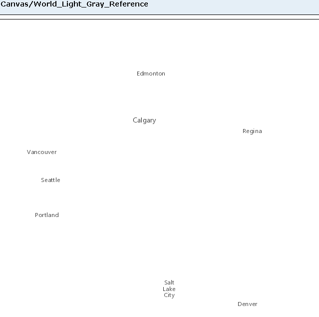

This is because the selected basemap consists of two layers: Base (Background) and Reference (Labels).
You can examine these using basemap item definition.
