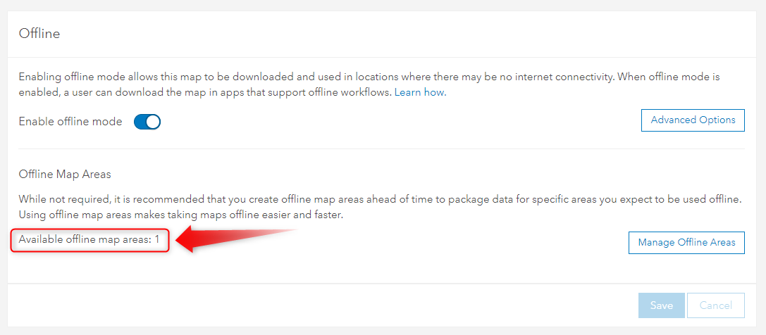

  • Added a Offline Map Rectangle to the Map

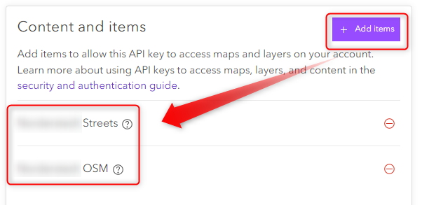

  • Added the Permission to the API Key to use this Item

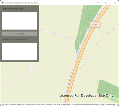

ShawnKleese
So i have started the Example-App with my License and my PortalItem/Map but i have the same Behavior - no PreplannedMaps Found:
So Something is maybe not corrctly configured in the Arcgis-Backend?

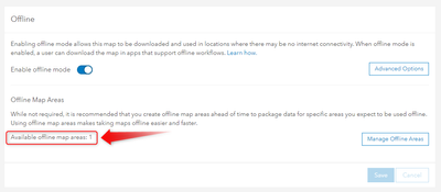

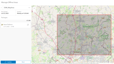

But i have added the Offline Area:
Maybe you have tommorow some Idea...
