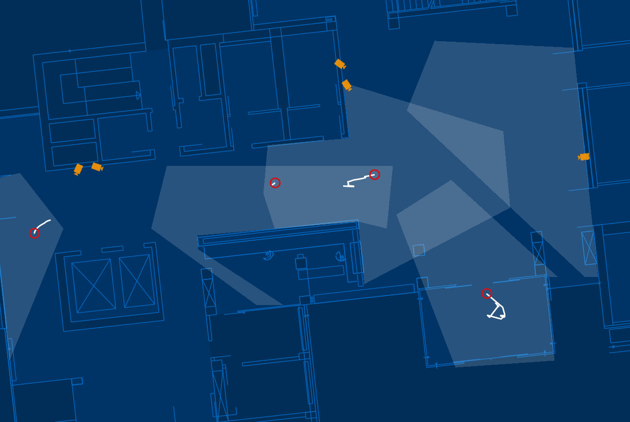

Is there an easy way to get the onScreen-coordinates of all visible Graphics objects?

Yes I meant the current map extent, like in this screenshot. The Icons are in different GraphicsLayer.
The method I tried is to iterate over all graphics layer, iterate over all graphics, check if the geometry is in the current extent and then call the JMap.toScreenPoint() method. Here is a snippet of the code:
