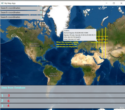

A quick sketch of what I should do

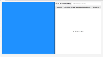

I'm going to get a MySQL. Below is the picture I show an approximate version of the program that I want to make. Instead of a blue square, there will be a map, and the table next to it will be linked to the database of cell indexes. I'm going to create such logic:
First, I enter the coordinates into a search engine that finds its exact location. I'd like to be able to mark it with dots/circles/a drawing pin. After I set the marker for the first area, I start searching in the same way for the other two areas. There will be 3 markers in total. I enter the coordinates -> searching process -> marking. With each search, it is necessary that the markers do not shift or disappear, they must remain in their position - accuracy is important.
Then I notice that the first point is located on the 10th cell. I enter the number 10 into the search, which is located just above the table - I get data about the 10th cell from the database. Similarly to the other two points. This part is a lot easier and I have a few ideas on how to create it. The most difficult part is the first one.
