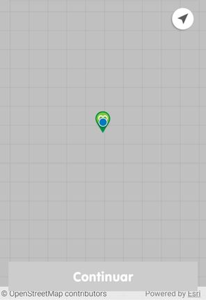

The map is coming out in gray and it does not show me the streets, the sdk that I currently have is 30  and this is the version of Sdk arcgis
api 'com.esri.arcgisruntime:arcgis-android:100.8.0'
I attach evidence:
WhatsApp Image 2023-02-27 at 3.23.46 PM.jpegWhatsApp Image 2023-02-27 at 3.23.46 PM.jpeg
can someone help me please

It seems to me, you are trying to load a streets basemap, per your question.
So I tried setting a streets basemap to mapView and load the mapView using
"com.esri.arcgisruntime:arcgis-android:100.8.0"
android sdk version, and it does load fine. I used an android 30 emulator to test this.
Below is the code snippet.

I've asked someone from the Android team to look at this, but can you share the code you are using to add the basemap.
