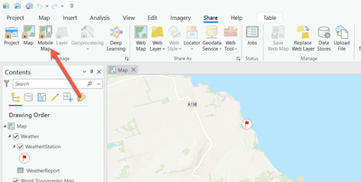

The file format you need to create from ArcGIS Pro is a Mobile Map Package - these are designed for Maps SDK apps.  The mpkx file will not work.  The publish buttons for these are next to each other:
I exported a project I have from ArcGIS Pro 3.2 to a .mmpk file and confirmed I can open and view the data using 100.15.x and 200.3 releases.
