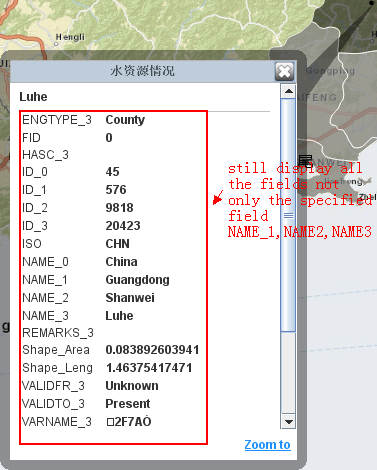

hello,
I use the PopupView and PopupDialog to create e a popup from the featureLayer and use setFeature function to display the feature like the picture below.But it will display all the attribute of the feature.I wanna to display the specified attribute.How should I do?In addtion,I use the shapefilefeature table to create the featureLayer.

But I have tried the setoutfiled in the QueryParameters.But it seems to return all the field since the popupview still display all the field.The related code is showed as follows.
