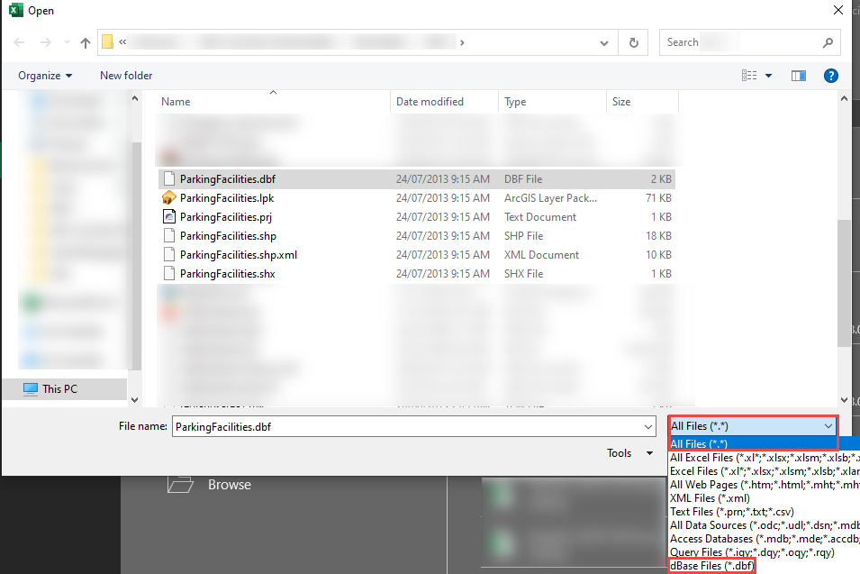

You can read .dbf files with programs such as MS Excel. You should not attempt to edit the file outside of ArcGIS Desktop/ArcGIS Pro however because it can corrupt the data.
The supported method of viewing DBF data is in ArcGIS Desktop/ArcGIS Pro by loading the Shapefile into your map and then Right clicking on the layer in your Table of Contents and then opening the Attribute Table.
To open the DBF file in MS Excel, Go to Open > Navigate to where the DBF file is then select open.
You will need to make sure the All Files or DBF Files file filter is on however.
