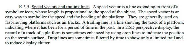

I've been working on a Java Desktop Application using the ArcGIS runtime SDK v100.7.0. There was a requirement where I had to display Point Graphics using Symbols from the MILSTD 2525D .stylx file. I was able to render these Graphic objects on the Map View just fine. Now, I've come across a requirement where I have to show these symbols with Speed Vectors. According to the official MILSTD 2525D documentation at MILSTD-2525D-PDF , it was mentioned here:
According to this, the speed vector arrow's length depends upon the speed of that object but I cannot manage to find any such attribute here https://github.com/Esri/military-symbology/tree/dev/military-overlay/mil2525d that can change the length of the "speed vector" present in the military symbol to be rendered.

The short answer is this is not yet supported by the DictionaryRenderer. So these lines would need to be drawn with a custom line symbol for now.
For now, as you demonstrated above, the speed attribute controls a label displayed on some symbols (like air, equipment) and the direction attribute controls a direction-of-movement indicator.
The longer answer is that I believe the standard doesn't require, or fully explain/specify the things shown in section K, so would probably require some more information to implement. Although, the speed leader is also mentioned outside of Section K in "FIGURE 13. Dynamic graphic amplifiers for icon-based symbols." Unfortunately, this section also doesn't provide much detail on how to draw, derive the length of the speed line, an error ellipse, etc.
I'll also forward this to the team responsible for the dictionaryrenderer to see if this in on their radar for a future release.
