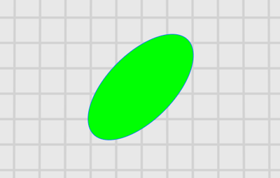

Looks like this:
Let me know if this helps

Looks like this:
