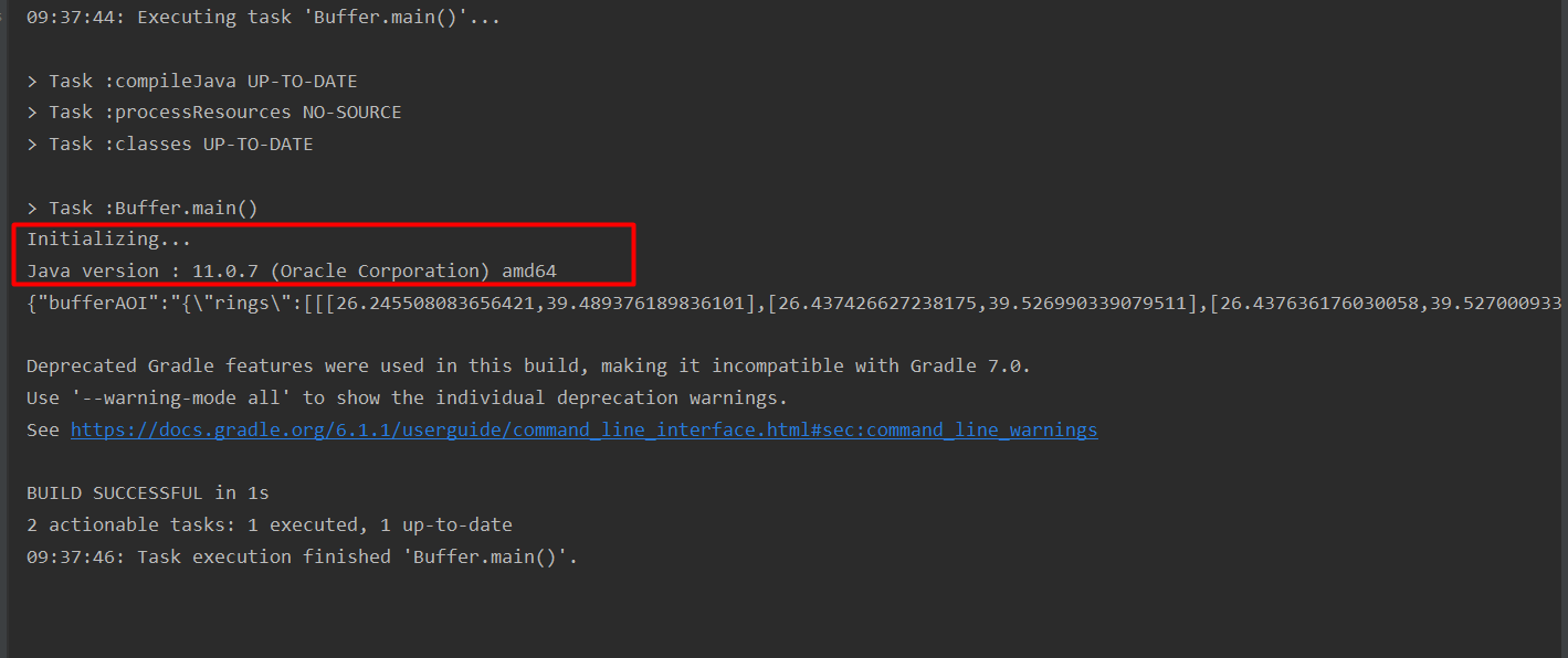

I have a very dumb question regarding the runtime, version 100.8.
I have developed a small application and compiled it to a runnable jar. Whenever I am running the java code or the jar in cmd, before getting printed what I need, the first 2 messages printed are : "Initializing... " and "Java version : 11.0.7 (Oracle Corporation) amd64" (see print sceen below)
Is there a way to disable/supress this? I suspect this is coming from within the runtime

Hello,
Thank you for your question: you are correct, those messages do indeed come from within ArcGISRuntime, and it's not currently possible to turn them off. Is there a reason that you would like to see this turned off, or to have the option not to display this message? We'd be interested to hear!

IonutAlixandroae1
Hi Rachel,
Thanks a lot for your reply!
Well, my reason is that created a small application and compiled it as a runnable jar (no GUI), and I`m calling this jar as a subprocess in a NodeJS API, and here I`m trying to catch the output from the jar and parse it (the JSON). Of course, without skipping those messages, my NodeJS API cannot parse a string like  "Initializing... " and "Java version : 11.0.7 (Oracle Corporation) amd64" because it`s not a JSON structure.
I was able to avoid/skip the first 2 messages and only catch the real output (JSON output) from the jar but I was wondering if there is a way to disable it because for me and in this case it`s not important. I`m only interested to see the output message from my application.
