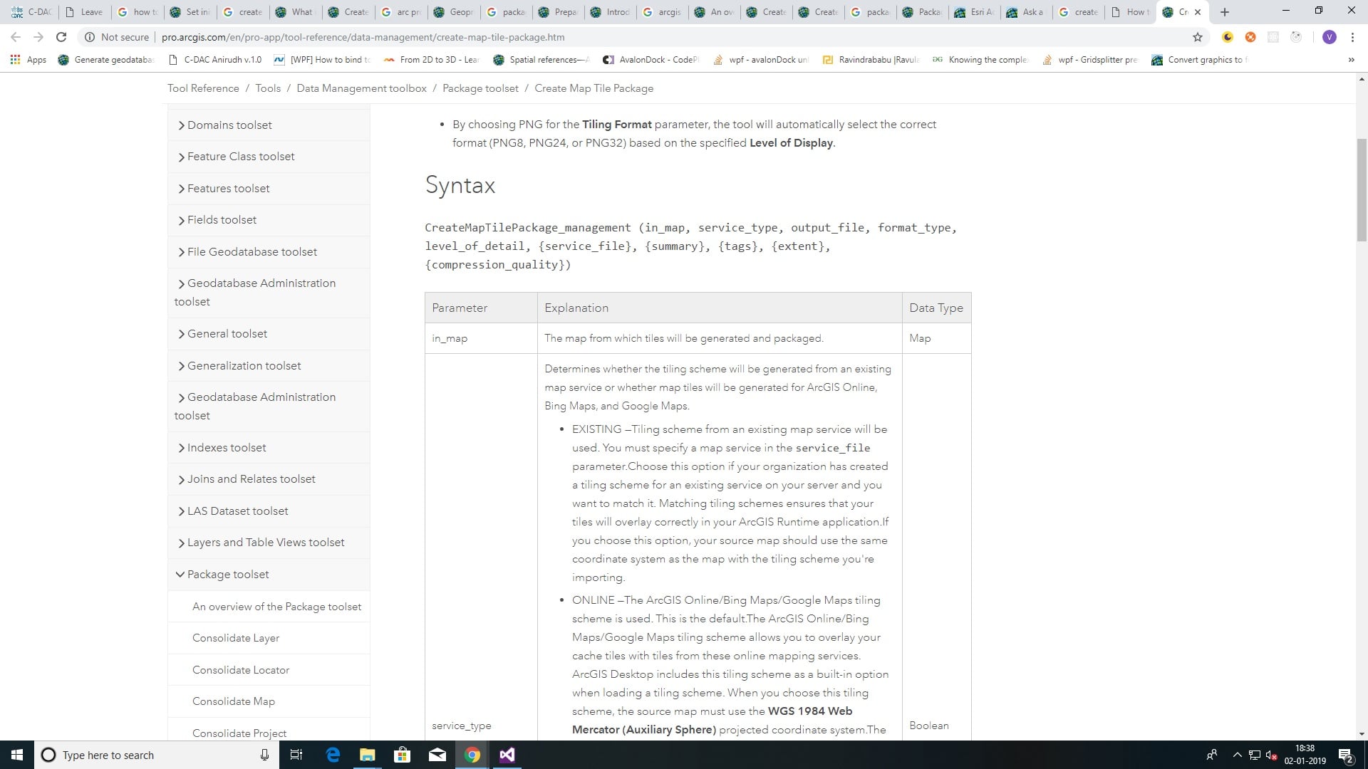

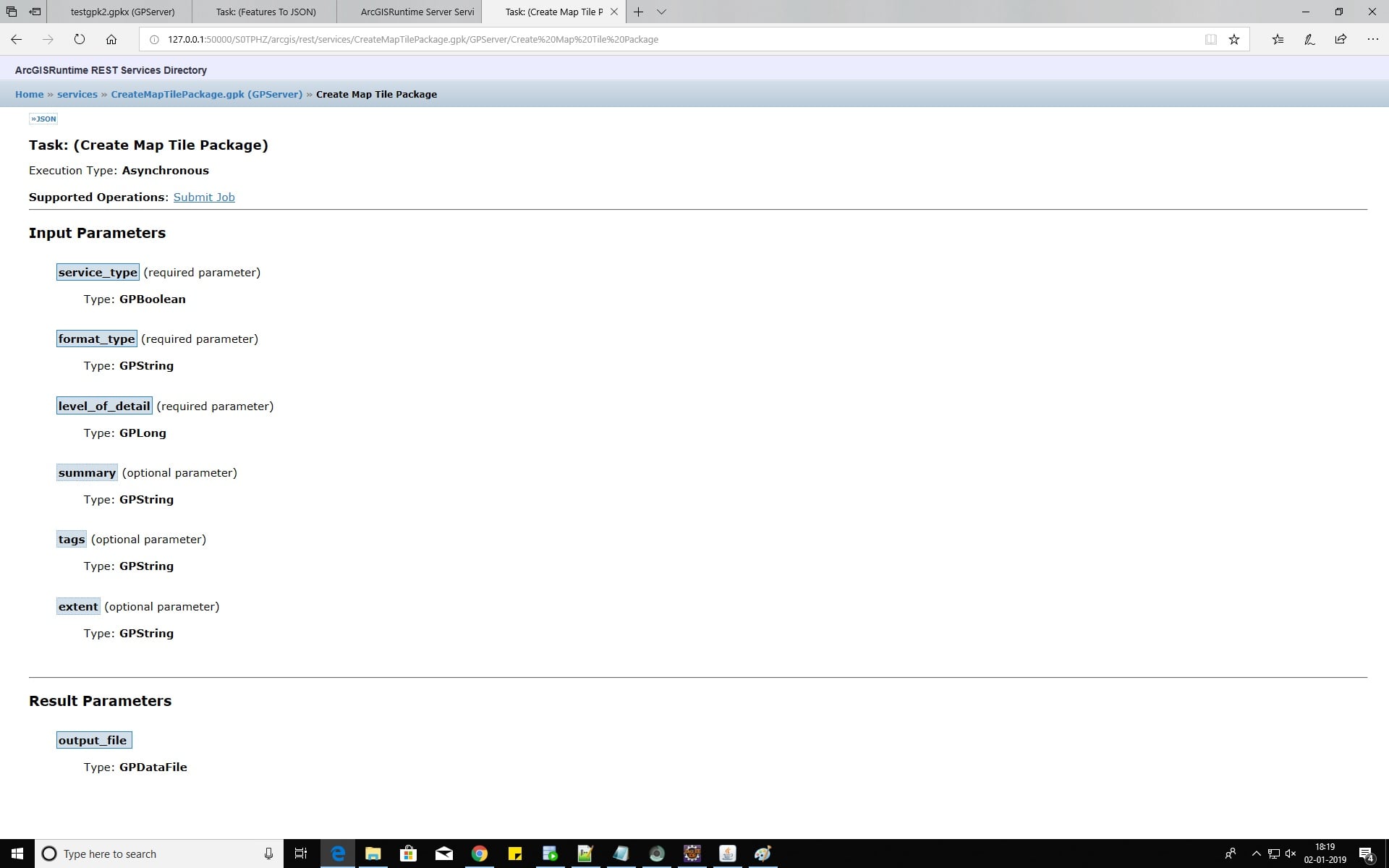

Hi,
My requirement is to create a tile package from a set of rasters using Runtime App , Since Runtime does not support creation of tile packages, so I tried to create a geoprocessing package tool using ArcMap (Data Management Tool - Create Map Tile Package ), but when I run my geoprocessing service , I am unable to understand how should I give Input Map document ?According to the ArcMap Documentation , the service should take an Input paramater in_map(Map)
but, when I run the service , I don't find any input parameter as (in_map) Map
What I am doing wrong ??

Hi,
Unfortunately the tool `Create Map Tile Package` is not currently supported. It was mistakenly added to the documentation when re-publishing the topic for v100.4.
But it is a tool we would like to support in future and the team has an existing issue logged to investigate adding support. Following your question, we will raise the priority of that issue in our backlog.

Hi,
Unfortunately the tool `Create Map Tile Package` is not currently supported for use with ArcGIS Runtime Local Server (Local Server geoprocessing tools support—ArcGIS Runtime SDK for .NET | ArcGIS for Developers).
I will open a new issue to investigate if it is possible to add this in a future release of ArcGIS Runtime Local Server (for geoprocessing packages created with ArcGIS Pro).
Looking at your screen capture it appears you may also have tried to publish the tool directly as a package. You should create a Model or Python Script to expose the geoprocessing tool in the appropriate way for a service (for example to control the input parameters and their data types). For more information see A quick tour of authoring and sharing geoprocessing services—Documentation | Documentation for ArcGI....
