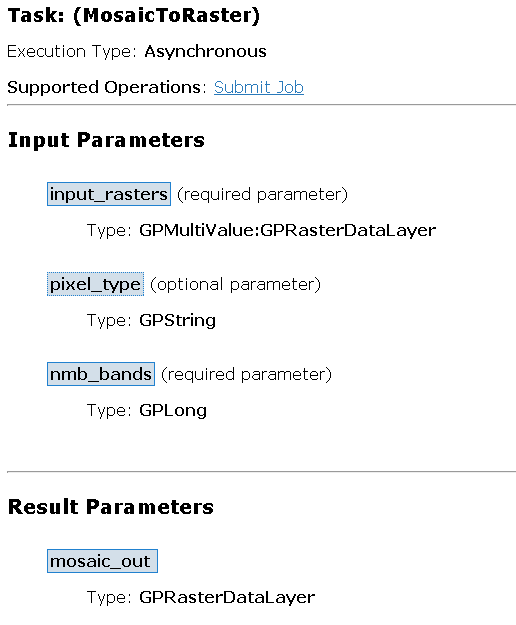

   I would like to ask you how I can pass a valid GPMultiValue with GPRasterDataLayer inside to the Local GP Service in ArcGIS Runtime 10.2.4.
My REST parameters are below:
When I run my sample app, geoprocessing service starts. After I submit my jobs, it fails. There is nothing I can read from the job info. The job output is below.
Below you find my Java code for defining input parameters.

AdamNicinski
Hi Eric,
   I created a model, composed of Mosaic to New Raster tool, which is supported by ArcGIS Runtime, in ArcGIS for Desktop. I have ran it successfully - the new mosaic was created. During the published of the resulting gpk, I chose the type of input_rasters as an user-defined value, not a default choice list. When I try to give my own input rasters, as described above, the gp service returns odd messages. Could you send me a link to any ArcGIS Runtime for Java sample application that uses GPMulitvalue with GPRasterDataLayer parameter? I can not find anything on the Internet.
