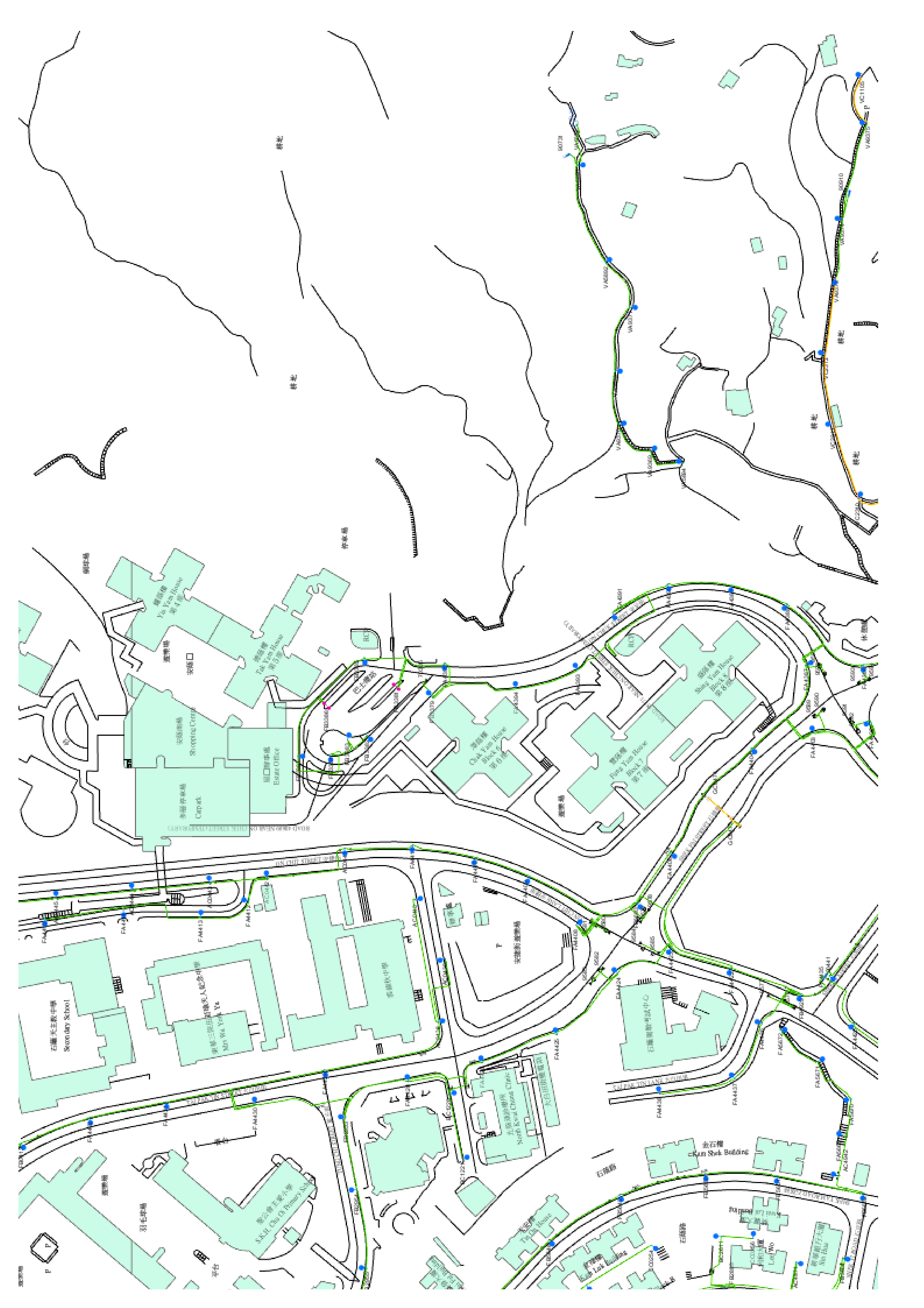

I have created a JAVA app which read the data from a ArcGISLocalDynamicMapServiceLayer created by a mpk file. The resolution of viewing the map is fine. However when I try this example Map printing | ArcGIS for Developers  and print the map, the quality is not good and the dpi seems very low when zoom in.
I would like to enhance the quality and try serveral methods:
1. Increase map dpi--  ArcGISRuntime.setDPI(1200);
2. Setting the printResolution in the print request attribute set --
Sample code:
PrintRequestAttributeSet printAttribute = new HashPrintRequestAttributeSet();
printAttribute.add(new PrinterResolution(1200, 1200, PrinterResolution.DPI));
printJob.print(printAttribute).
But none of them perform well compared with the map printed by the ArcReader.
May I know any way I can enhance the printing quality?

Hi Norman. Adam is correct. The functionality here is simply for exporting the map image and using it as-is.

Thank you for the confirmation. I am studying the latest sdk 100.0.0 and may I ask is the vector tiled layer(vtpk) could provide a better quality of print image?

One is using the REST API of ArcGIS for server  "export web map". the dpi can be tuned but the processing time is not desirable.
Another way is using the ArcGISReader Control library to output the image via arcreader, though publisher license is necessary and documentation on this method is not well organized.
