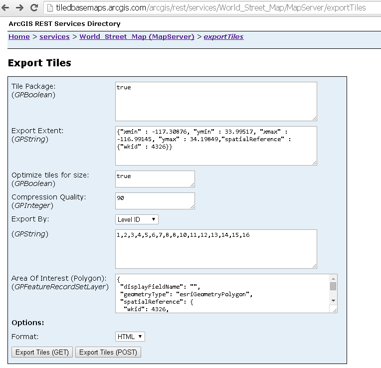

I recreated your tpk request. The REST API request page looks like:

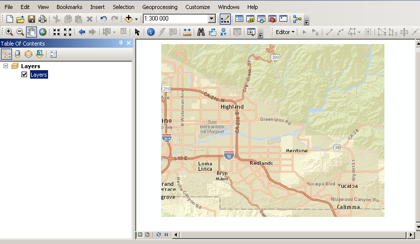

The resulting tpk is 34.6MB large. I added the file to ArcMap, and I could display it at all scales:
Please, check your request parameters first. There must be something wrong there.
